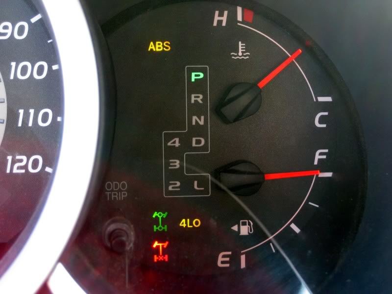

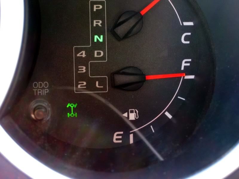

    This is the 4WD light (high range):
    This is when you go into LOW RANGE:
    This is the Rear Locker light (on with the 4WD-LO lights):
    Notice there is an X over the rear differential (a locker stops differential action). No ABS when locked (ABS light is on).
