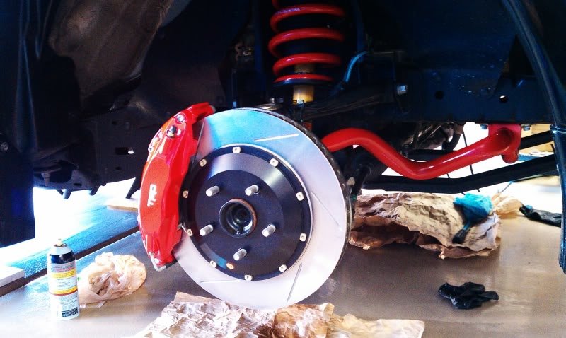

    Found this pic of my rotors before I swapped to a BBK. Threaded bolt holes are at 6 & 12 in this pic.
