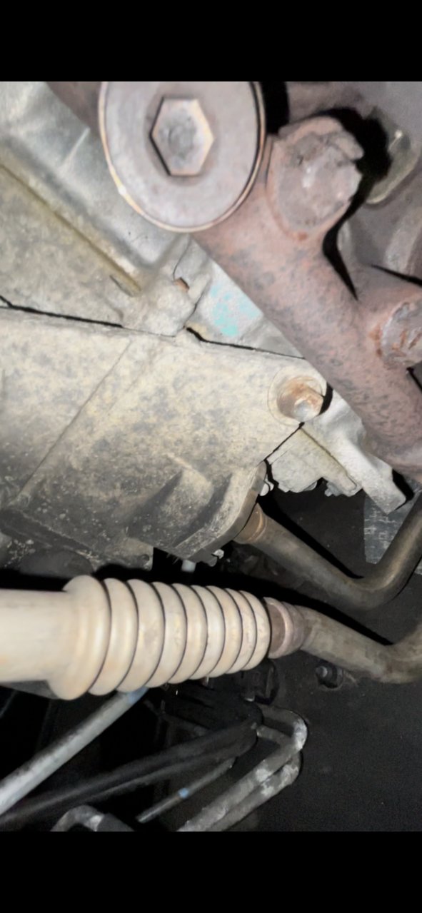

    This is right above the manifold

    Is the soot on the rubber hose? Check the flexible metal pipe for a crack. Might need a pocket mirror. Or stick your hand back there with it running and see if you feel hot air coming out

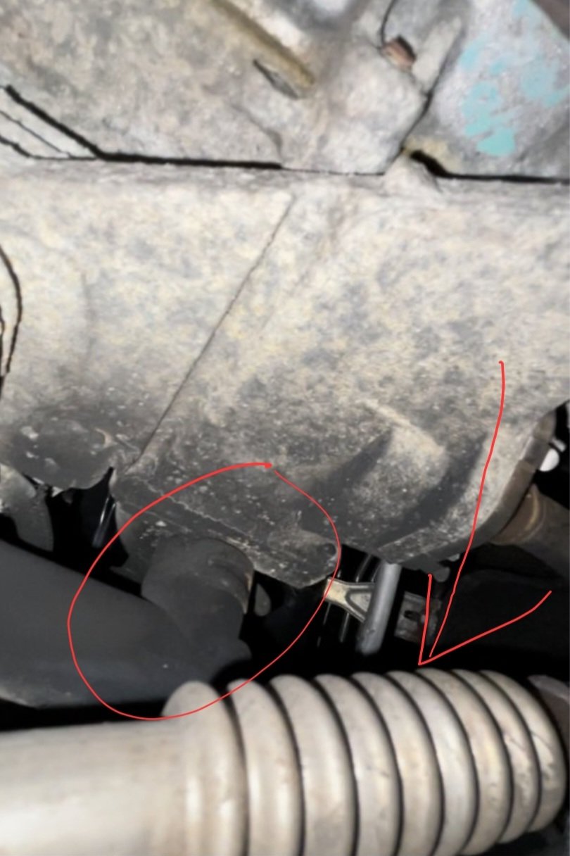

    Looks like this pic is looking UP from the wheel well and at the firewall.
    If you are not throwing any codes for emissions control or going into limp mode. Im betting this mating surface is your culprit. This is a pipe for the clean air injection on startup, The pipe/mating surface etc all see hot exhaust gases a but if there is an issue with the valves above (where the rubber hose attaches) there are pressure sensors that will throw a code.
    I would (ON A COLD MOTOR). Have someone start the truck, hood open, and feel around the area gently for exhaust leaks where circled and where the pipe mates to the exhaust manifold itself.
    If the leak is there we can help you with some part numbers.

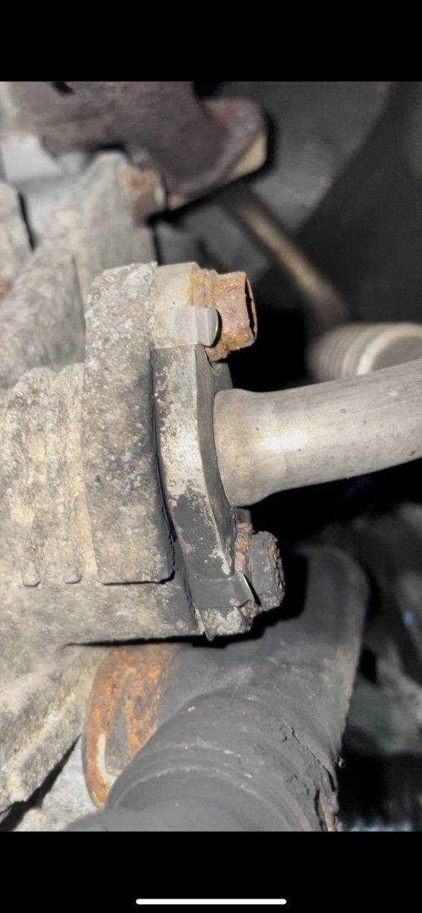

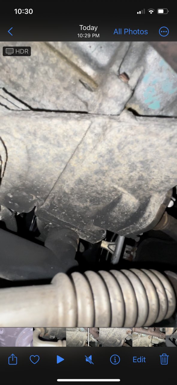

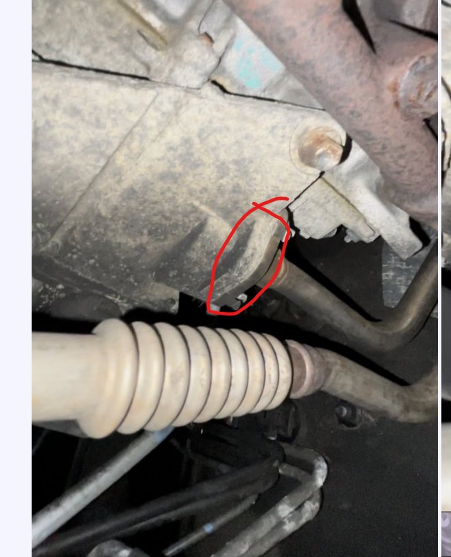

    I think you might have just saved me a lot of headache and money good sir. I felt around in there and I did feel a leak, followed it. I have a picture of where and the leak is visible. If anyone can help me find the part number for this, it would be greatly appreciated. The image is taken from directly below the black hoses shown below

    It looks like the leak is on the SAIS valve side and not on the exhaust manifold side? IF SO The "gasket" is a metal crush washer / metal gasket of sorts. Toyota Part number = 17377-31010 grab two of em as they are cheap.
    You are also going to want to grab some good penetrating oil to soak down that whole area for at least a day with how rusty those bolts look. My recommendation is AeroKroil makes PB blaster look like childs play. (WEAR GLOVES)
    https://www.amazon.com/Aero-Kroil-L...d=1696112530&sprefix=aerokroil,aps,138&sr=8-3
    Probably want to replace those bolts too. ill bet M6 standard thread, get some 25mm long ones and you can cut them down if need be. But you could pull them out and then go to any hardware store in another vehicle too.
