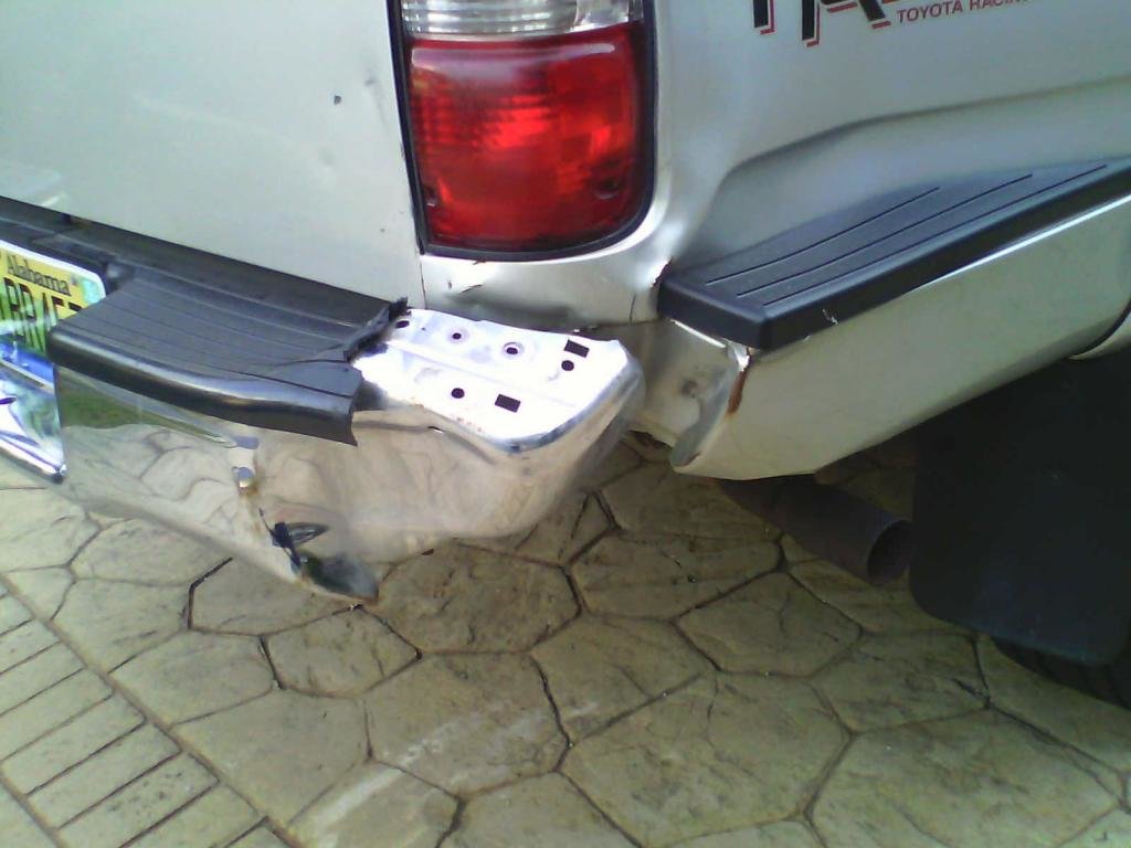

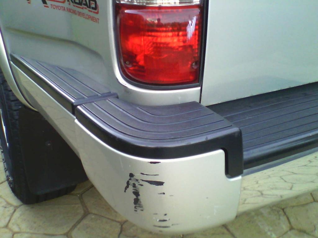

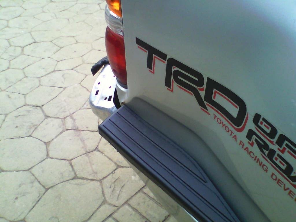

    Thanks for the info guys. Didn't think there would be much to it. I do have the step plates on the top of the bumper, and they are also on the wrap around corner pieces that connect the bumper to the step siding. I assume these are just bolted on as well?
    Threw in a few pics. I imagine I will have to pull the step plates off all three pieces, then unbolt em. May try to tackle this this afternoon after I get off work.

    I got the step corner off last night, went to undo the bolts on the rear bumper and couldn't get enough leverage on them with a socket wrench to get them going. I'm gonna go up to my other job today to use an impact driver to get the bolts loose.
    Thanks for the info about them slipping in and out of the brackets, i wasn't aware of that. I'm a complete beginner to working on vehicles and just trying to make sure before i get into anything that i know what lies ahead.

    I replaced the bumper last night with the aid of a friend. The two bolts on either side I was thinking i'd just pop out to replace the bumper were actually welded to the frame. To get the bumper off there were 4 or 5 star bolts on the underside, and two bolts w/ nuts on the top under the step plates and one on bottom on either side. Everything went pretty smooth takin it off until we got to the corner that had been banged up. The way the collision pinched the bumper in made it impossible to get to the last nut on the bottom of that corner. We took a pry bar and had to pry the old bumper away from the frame to get to the last nut. The mounting bracket on the corner was bent from the collision, so we took the pry bar and made it close to straight. Popped the new bumper on with no problems. Took a couple hours, mainly just messing with that corner.
