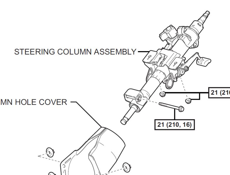

    If the steering column has come loose from the dash mount you probably have broken / bent fastening or clamping parts in the column. The repairs could range from replacing a few pieces or the entire column.

    Here is what we are discussing:
