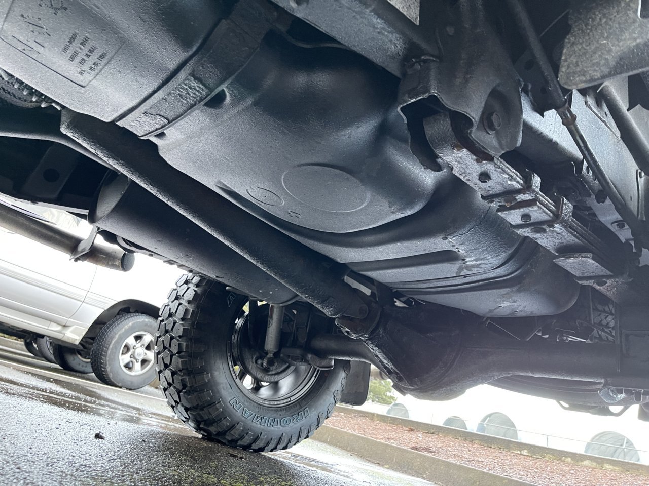

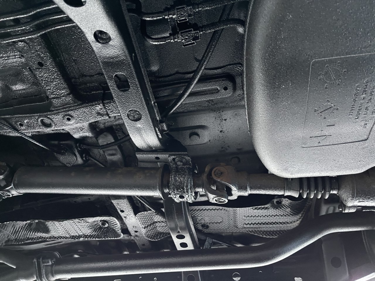

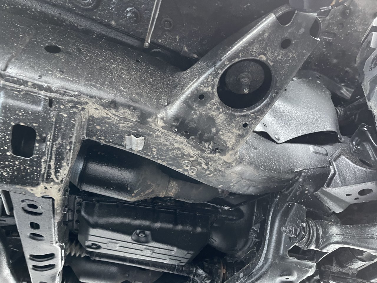

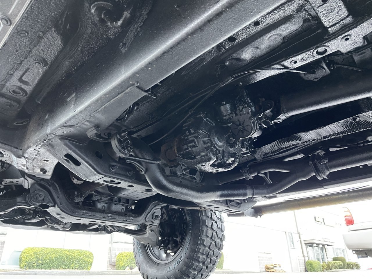

    You live in Oregon, just walk away, why do you want to buy a truck from NY. You can get one where you live without rust. The undercoat they sprayed will actually make the frame rust faster once water or moisture gets trapped inside of it.

    The frame was replaced due to perforation (caused by the rust) discovered during the inspection.
    Is the film coating oily where you can remove it with your finger or is it actually adhered to the surface?

    It looks to me like the dealer used Noxudol, which is what Toyota was using for a while as part of the frame settlement inspection/treatment. They quit using it because dealers were not applying it properly. Ask me how I know!
    When applied properly, it's amazing stuff, but applying it properly involves getting every single particle of existing rust removed. I can absolutely guarantee that wasn't dine - that was a run and gun job to make everything look decent, which, as others have said, will actually make the truck rust worse over time as the rust continues to form underneath the coating, and you won't know about it until chunks are falling off, since the Noxudol holds everything in place while it decays.
    Getting that stuff off involves a lot of solvent, wire brushes, and cursing, and if you're serious about keeping that truck, you would need to get it all off.
