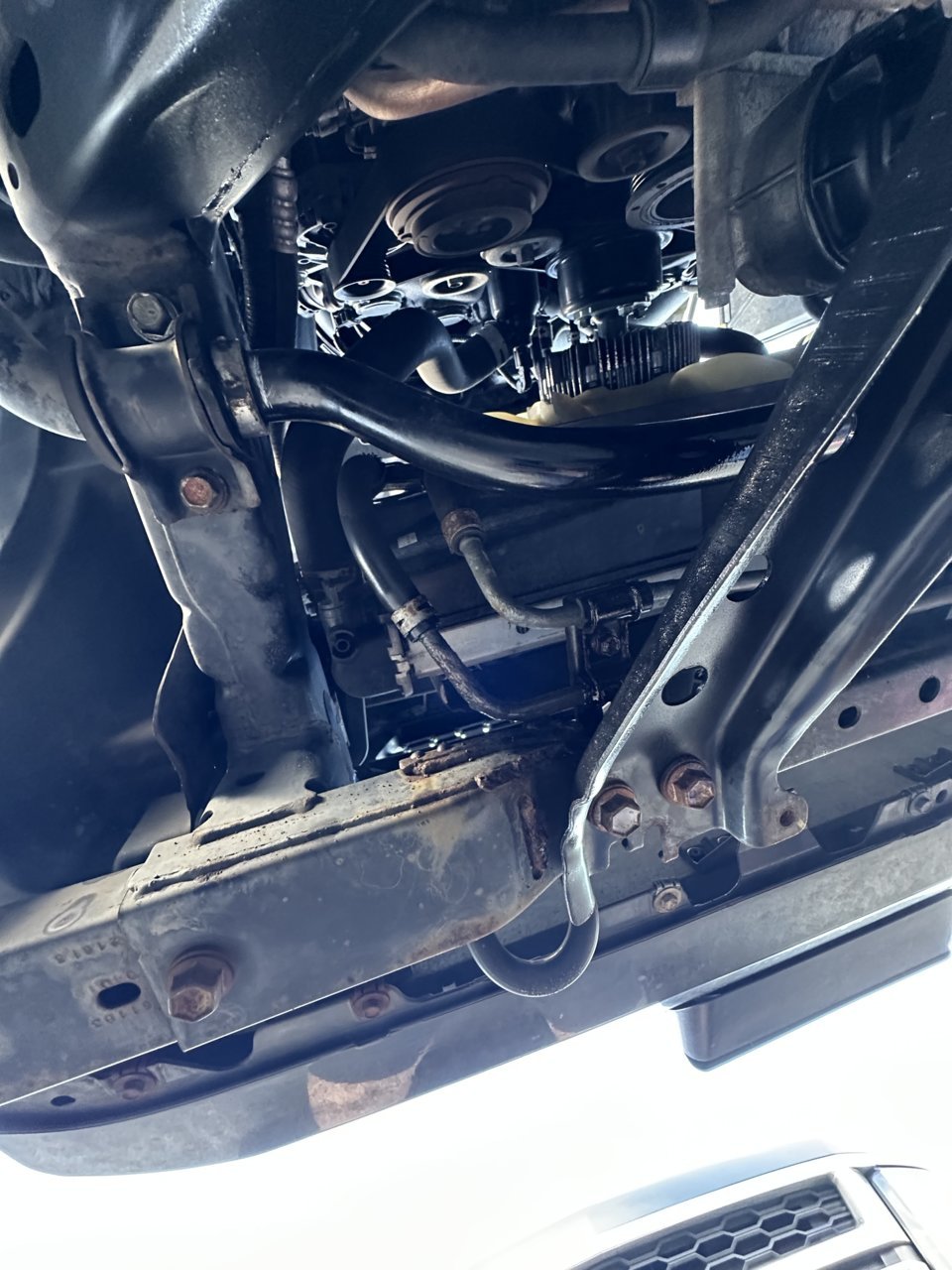

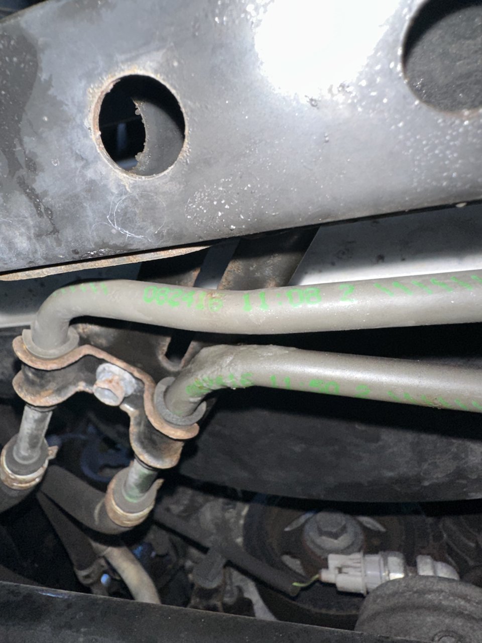

    Hey guys I am looking for this part and it’s been hard to source because I don’t have the part number someone help please!!! Looking where I can get this transmission coolant line. mine is corroded and leakin

    I think this is the part # you are looking for 32907-04010

    I looked up that part number for my 2017 Toyota tacoma TRD sport 2wd and it says it does not fit my truck thank you for your help. Just not sure what to do from here

    32921-04110 would be the lines for a 2017
    Sorry, that was for the 2.7L not the 3.5L
    It might be 32922-04150, but it shows a different item image, which is the external oil cooler lines. But the actual part number for the ext. oil cooler line is 32907-04060.

    Thank you so much for your help! Seems to be the correct partyou guys are life savers
