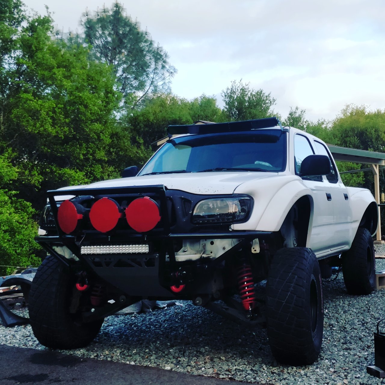

    RedManRocket
    RedManRocket Well-Known Member
    Mar 18, 2015
    #151238
    2,298
    Red
    Sonora, Central Cali
    2002 Double Cab LT
    Esb 5.5 with Kings Mcneil 6.5 fenders Other stuffs

  9. Oct 6, 2019 at 8:21 PM
    #69
    Tacoman100
    Tacoman100 [OP] Active Member
    Sep 12, 2019
    #305093
    43
    Damn this ones sick!

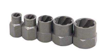

    Blue Truck
    Blue Truck Well-Known Member
    Jan 28, 2019
    #280939
    111
    These work great
