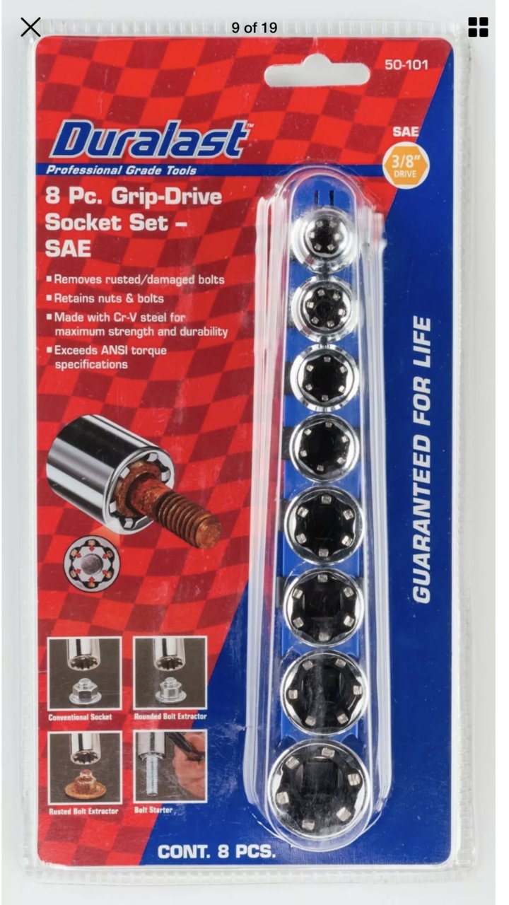

    These are the sockets use use to extract damaged bolts. The little tabs in the socket move and actually grip down on the bolt as you try to turn. The more force you turn with, the harder they grip. May be worth a shot.
  5. Oct 7, 2019 at 9:03 AM
    #85
    Blue Truck
    Blue Truck Well-Known Member
    Jan 28, 2019
    #280939
    111
    They are tapered. I once ground about 1/16" off of the depth and it bit deeper to get the fastener out.
