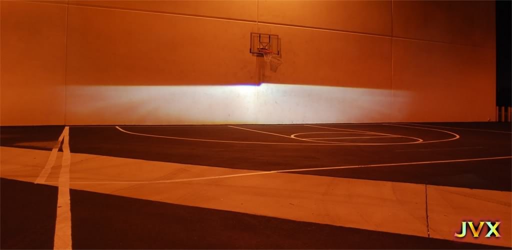

    So... Since they are all put together now I assume I recommend that you do this. Remove the headlight and the bulb. Take a very bright flashlight to the back of the projector and shine it towards a light colored wall. This will tell us whether or not there is something wrong with the projector or if the bulb is seated incorrectly (maybe both). Or you could just try and adjust the bulb by unscrewing the twisty things that hold it in place and moving it around trying to get it seated correctly. Your beam should look like this:
