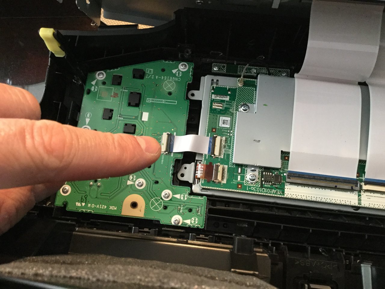

    So here I am. I gave up for a while on fixing my screen and now I'm all motivated to do this. Does anyone know how to detach the flat CPU wires from the screen??

    That looks to be a zif connector.
    Try this video. Basically shows how to remove it. You lift up on the connector and carefully remove cable.

    Thank you sir!
