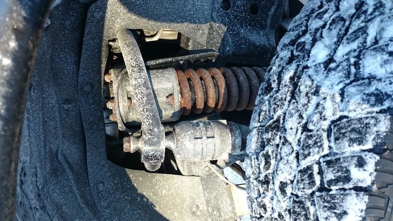

    I was seeing if anyone new what type of suspension lift this is i bought the truck used. It looks like the kid before me put some money into it. The mechanics I took it to all said the have no idea what type it is. It has a stiff ride to it also

    :eek: Spacers.....

    It's an old drop bracket lift (you can see the spacers on the spindle). The name is escaping me though. Piece of shit.

    It's not purely a spacer lift. It's a DB lift...which typically have options. The cheapest is to add spacers on the coils and spindles to match the drop bracket.
    OP...take a picture of the front. You should see a bracket that drops the front diff down.

    Is that the older trail master kit?

    No. That was the biggest piece of shit DB lift made. It didn't utilize a UCA. it had some funky thing that hung off the top and attached to the spindle making it act like a strut instead of a dual arm coilover setup.
    The one pictured is an aftermarket UCA and a DB lift.

    In other words you'll be spending some money in the near future. Not the best lift and most of tw would advise against these lifts.

    Neighbor said procomp 4"

    bingo, Procomp 4" DB

    My brother has that lift on his 01 yota. Terrible lift 4 inch spacers and ball joint spacers and 3 inch blocks.

    looks like a uniball uca which is decent
    but the giant spacers aren't a good sign of a "quality" lift
    like lifting the truck for the sake of lifting it; not really gaining anything but height. try take a picture of the bottom of the front of the truck; a frontal with emphasis on the area around the diff and we can tell you exactly what you have (A couple more pics would be nice)
    we can tell you what's going on out back too
    be glad it isnt a trailmaster lift, at least. lol
    those coils look like they'll bind after just a few inches of uptravel
