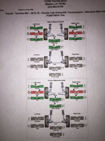

    i lifted my 2016 trd off-road with a 2.5" in front and 1.5" in back with procomp es6000 shocks I got an alignment but my tires or still bowed. Do I have to get new upper arms to make it completely straight again? Thanks for the help also I'm new to this so he help would be appreciated...

    Sounds like camber is off. Show pics please. Did u get an alignment if so please post photos of alignment specs

    IMG_0526.jpg They said camber looks good and yes I got an alignment today

    Did they not adjust anything? The before and after are the same.

    They adjusted toe by .01 duh
    OP whoever did your alignment charged you and didnt do anything

    Literally the only change on that sheet is that your total toe decreased by .01* Your camber is too high. Likely need UCA's to get it dialed in right but try aligning without first due to their high cost.

    And if they couldnt get it within limits due to UCA's they shouldve told you.

    OP, what do you mean "bowed"? Cupped, feathered, heel toe, or just dorky looking with top is the tires sticking out more vertically?
    Never mind, just saw pic. You have street car camber. Opposite of what I said. You got robbed... barely made any adjustment to the toe values.

    Yeah they screwed me hard I even went back and they said they can get it straight if they put it back to factor.. and yes Gonzales tire and auto did it...
