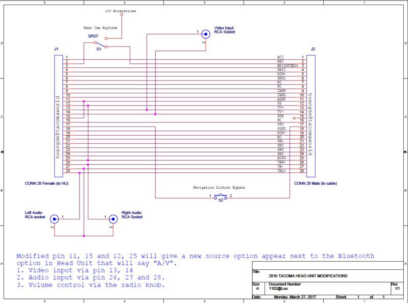

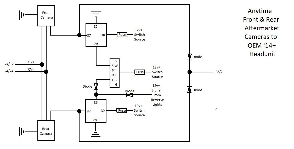

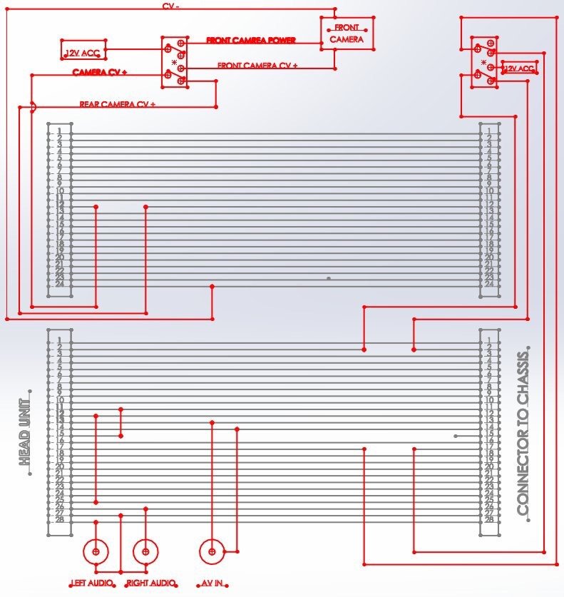

    two camera switches for the anytime camera and backup camera. I cannot find a dual switch so i well have one for the front and one for the rear camera. Thanks for any help.

    Check these out. C60F3A48-934A-4014-A639-60628C6A7781.jpg20F4B69F-66B6-4F25-B47E-3CE6B0476D5F.jpg 560732DD-B5CC-42B0-B485-2A3A3E0F0635.jpg

    OK thats what i needed. Thanks
