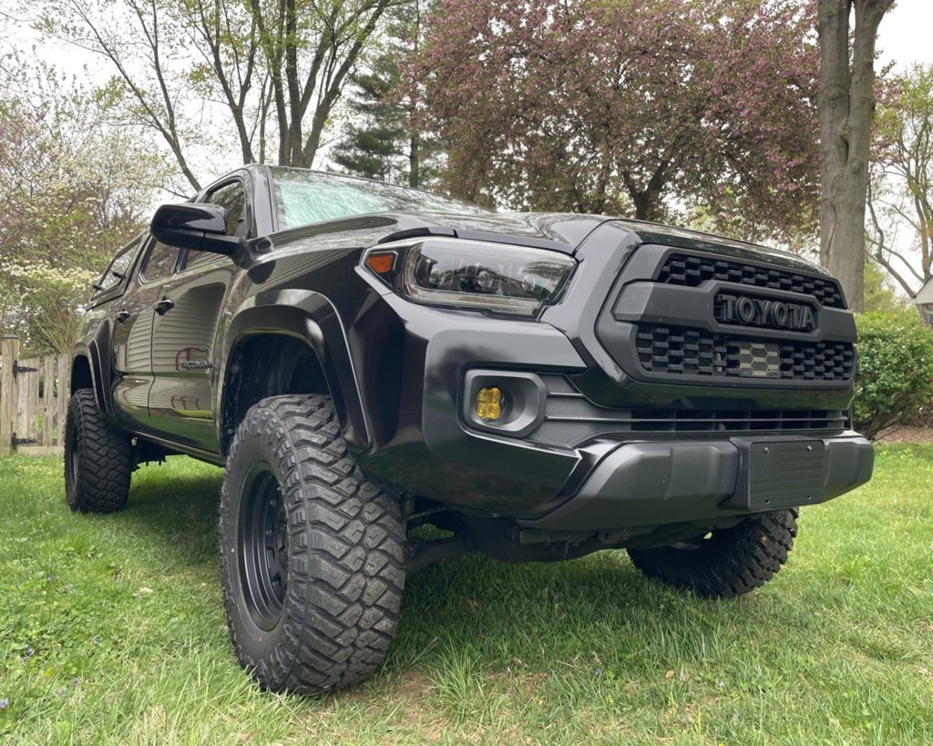

    I also vote for the Bilstein 5100’s. I travel around North America in my truck and do a decent amount of light-to-medium off roading along the way. I’ve had the 5100’s (front and rear) for about 50K miles now and I love them.
    pic of my truck just for fun:
    I think they are an excellent mix of budget friendly and reliability.
