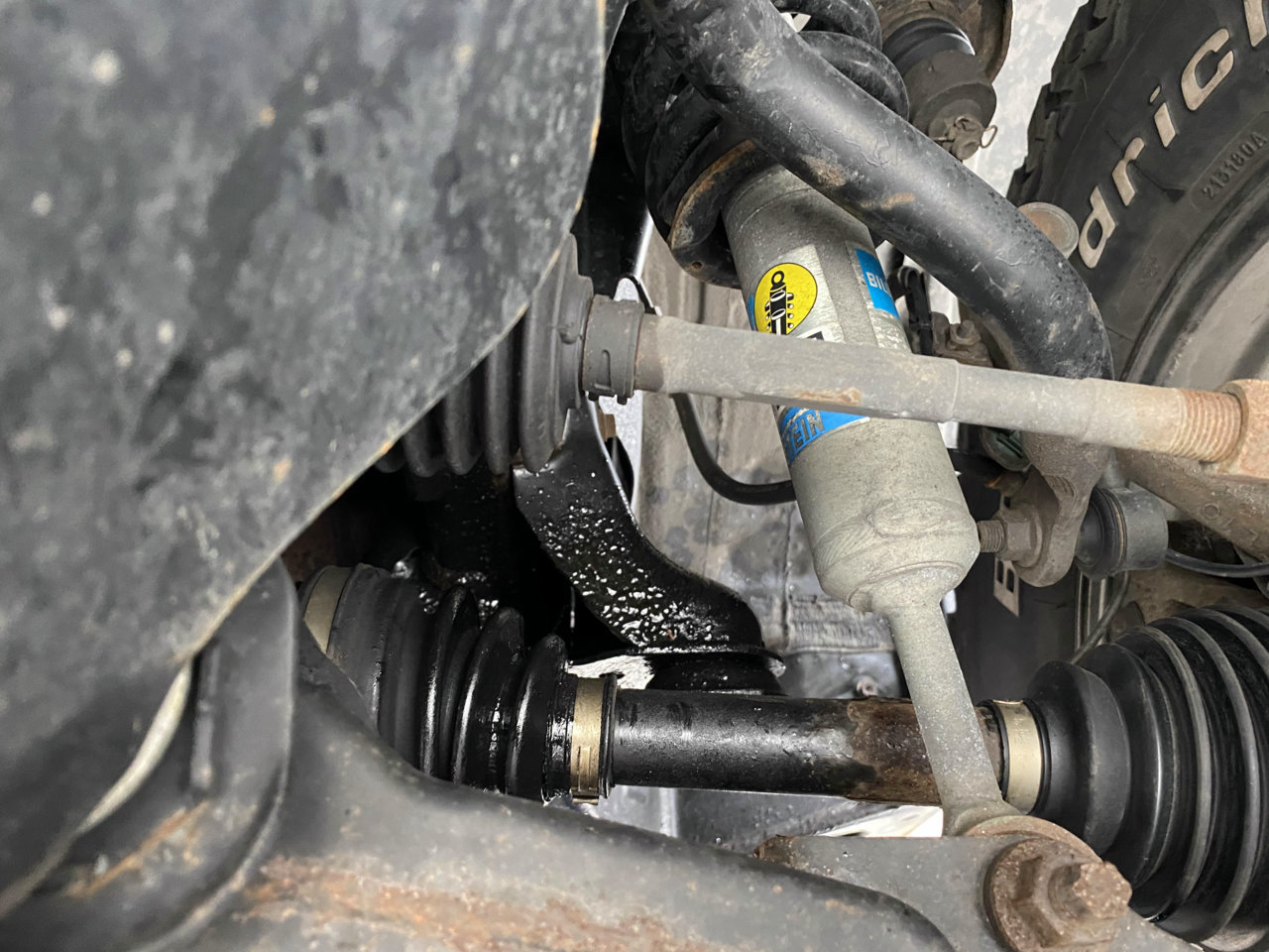

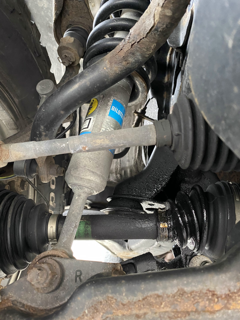

    Here are some pics of the truck, lucy & the leaking cv axels to make this tread less boring :) IMG_2737 2.HEIC.jpg IMG_2310.HEIC.jpgIMG_2308.HEIC.jpg IMG_1736.HEIC.jpg

    By your mileage, my carrier bearing, and LCA BJ’s and bushings were shot, but I expected that from the off-roading I do. I had also replaced both front wheel bearings. My u-joints looked good but I replaced them with non-greaesable Spicers. I still have the original front driveshaft u-joints - they get stressed only when you are in four wheel drive mode, so they should last a long time and are unlikely to be the cause of any current imbalanced issues unless they have been damaged by road debris. The drop kit wouldn't hurt.
    The BJ’s look like they need replacing. Your call on replacing just the BJ’s or the entire LCA’s, but avoid the cheap aftermarket LCA’s cause they come with cheap made-in-China bushings and BJ’s. The LCA’s appear to be of decent quality. I currently have Dorman LCA’s. The BJ’s barely lasted 1500 miles and the bushings now need replacing, after about 30K. I have refurbished my oem LCA’s and will be swapping them out sooner than later.
    The ECGS bearing swap may not be a bad idea if you are going to replace the shafts, but I would do that last and only if they ate the cause of the vibrations.

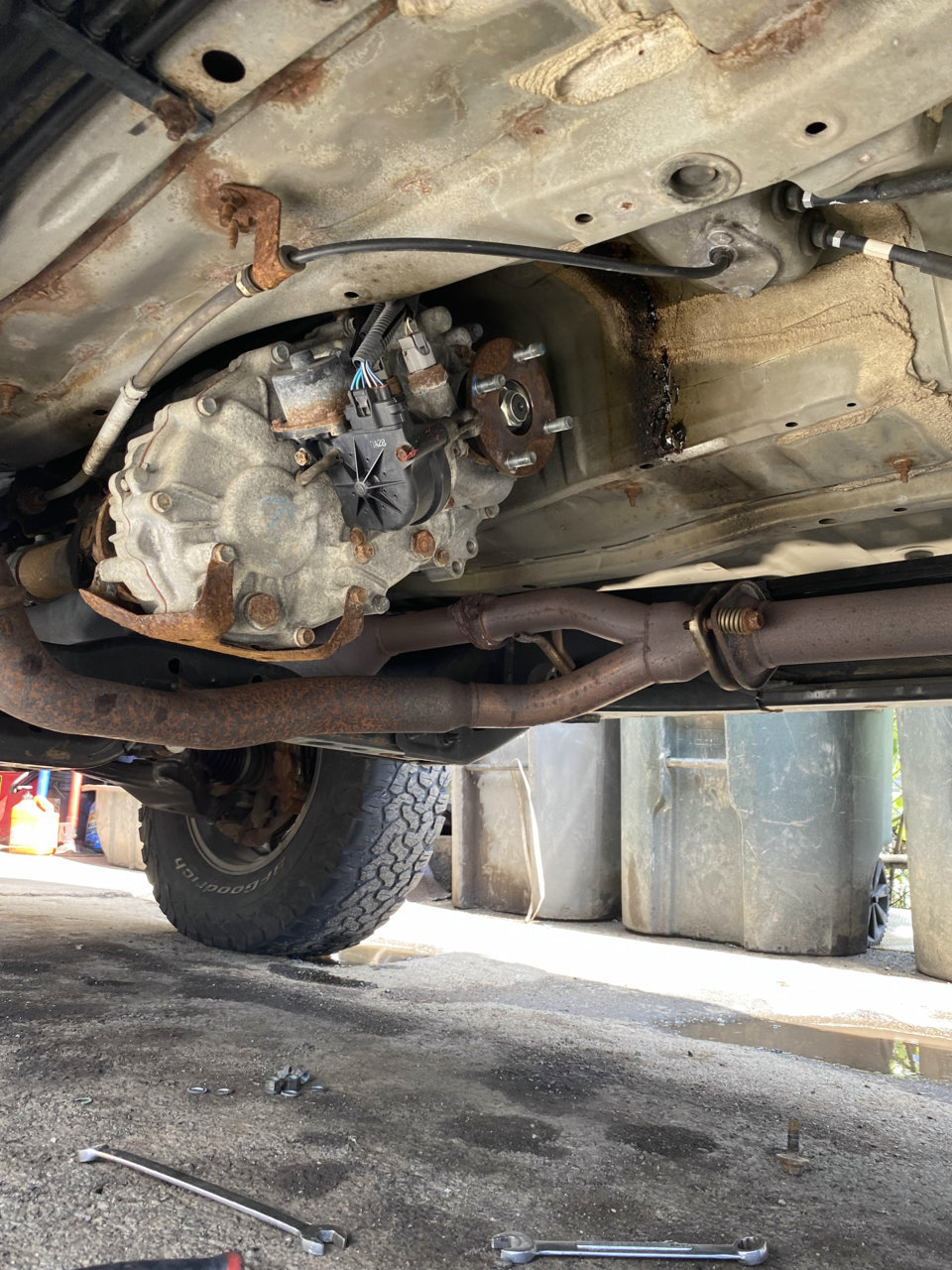

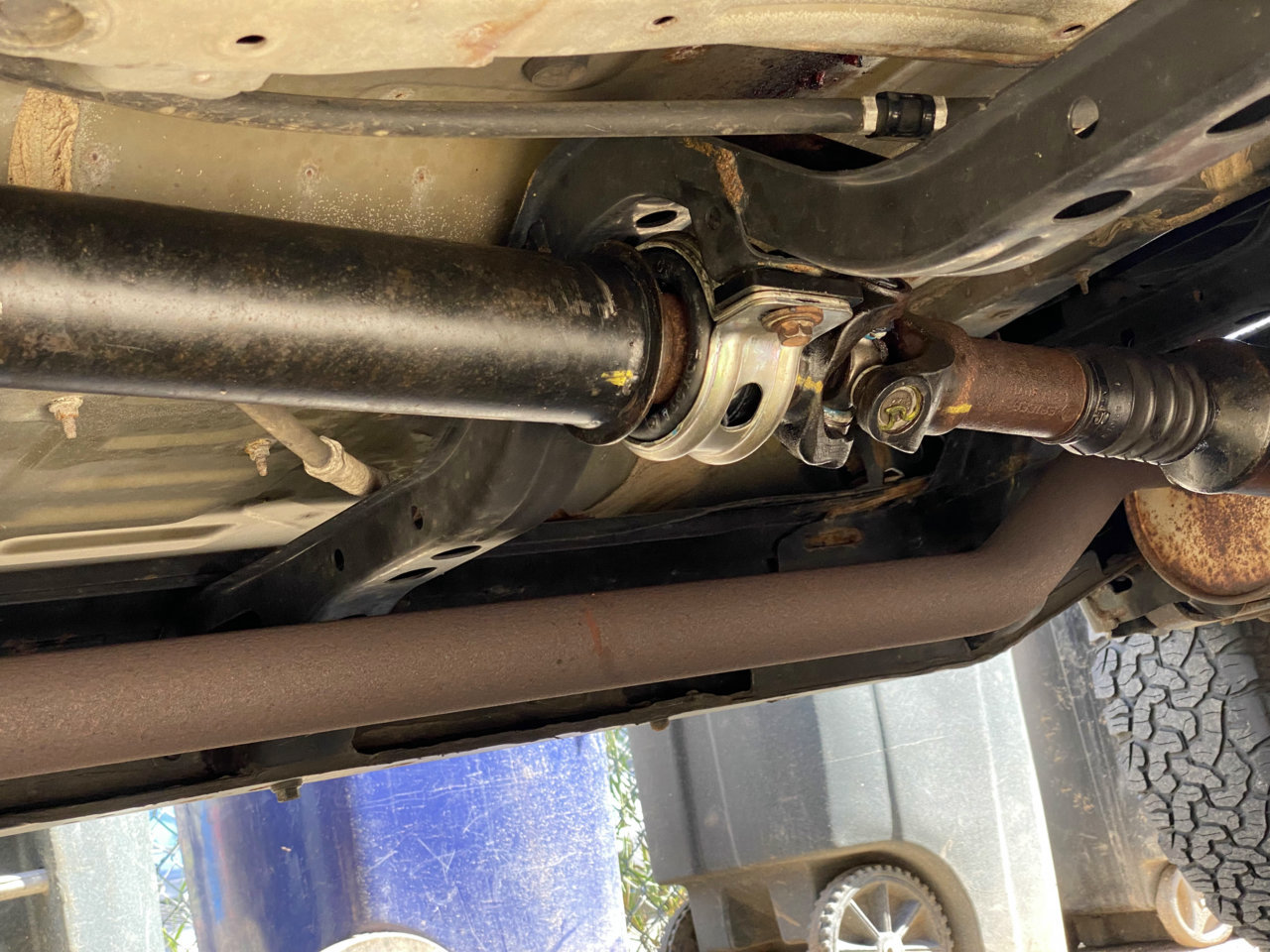

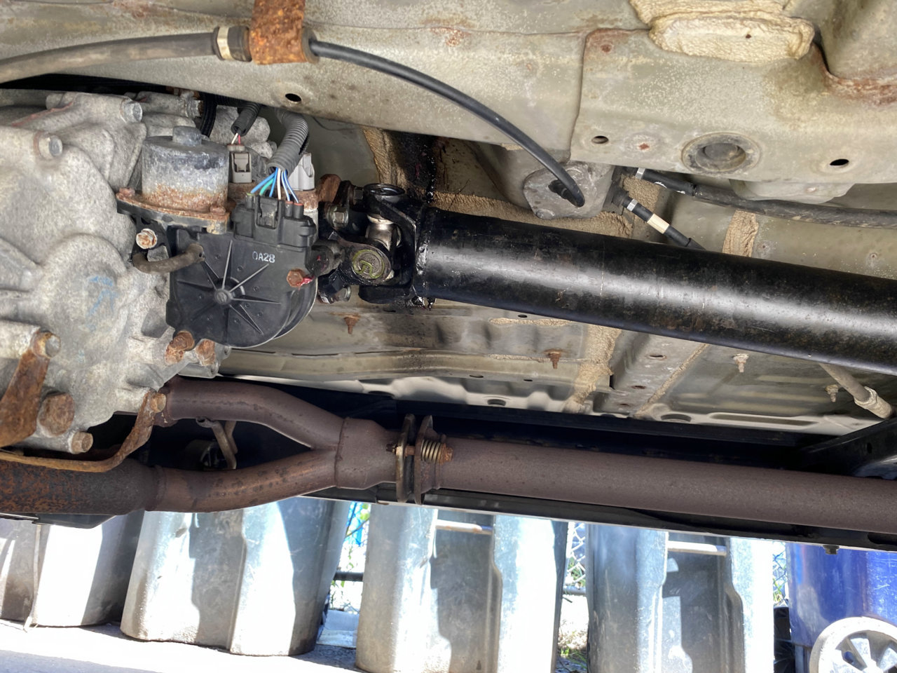

    Installed the three u-joints, carrier bearing and emu drop kit. Truck rides smoother than ever! Thanks for all the advice.
