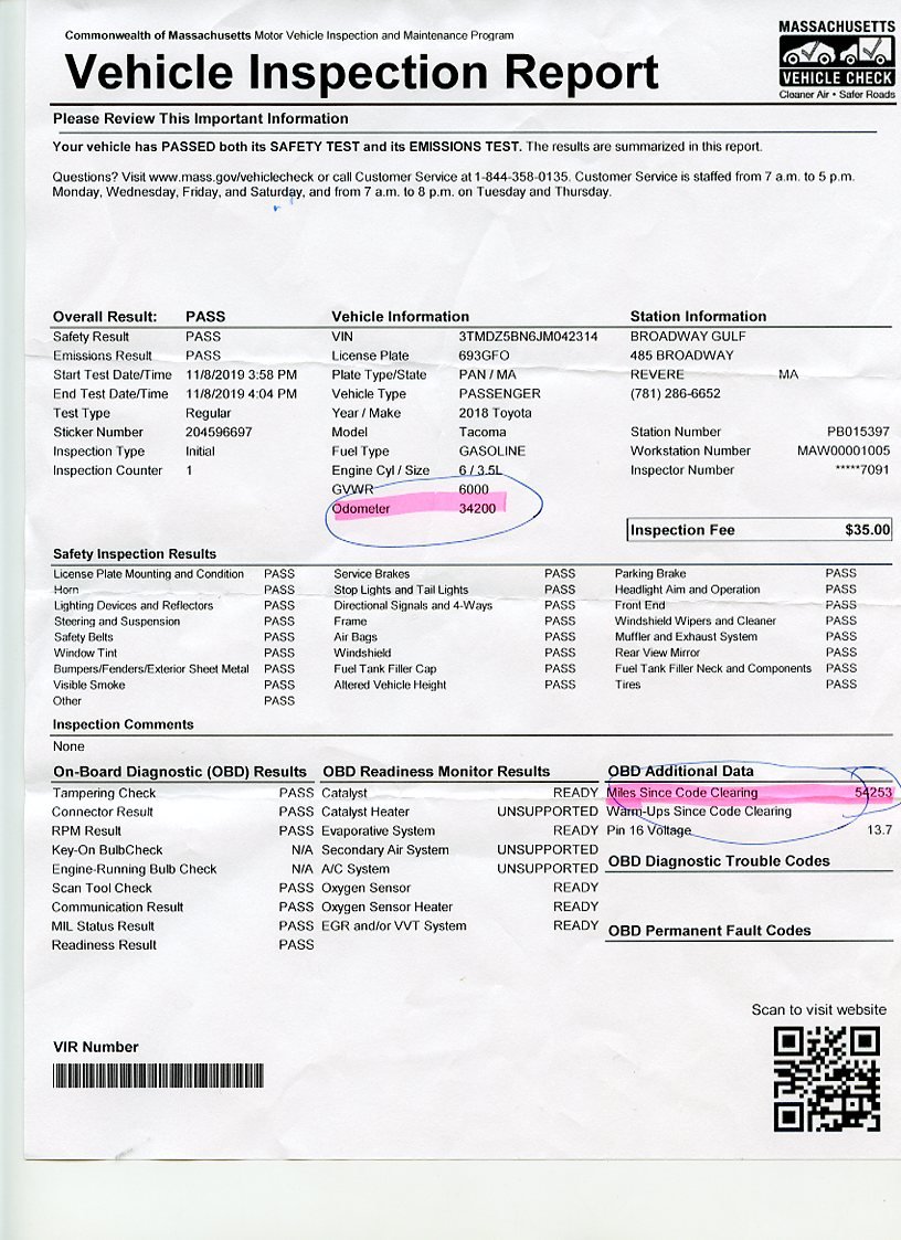

    Bought my used 2018 TRD Sport on 10/28/19. Had inspection done on 11/8/19. The odometer read 34200 miles.
    Under the "OBD Additional data" it says "miles since code clearing", it says 54253 miles since it was cleared. I think I've been screwed.
    Anyone have any input? There's a copy of my inspection below. This leads me to believe the odometer was rolled back, but the true mileage is
    being stored somewhere else other than the cluster. How else would the 54253 miles show up?
    By the way, I bought this Truck at a reputable Lexus dealership.

    I think that is the miles since any emissions fault codes were cleared. Since it’s more than your mileage I would guess they’ve never needed clearing. It should be easy to track your mileage through a car fax report.
    Also, it’s quite a bit of work to replace the instrument cluster. I doubt anyone is doing it to rollback the mileage by 20k. Just seems like a waste of effort.

    I would guess that the codes have never been cleared and that 54k is just whatever random data that spot in memory had in it the first time the computer booted. Lazy coding can cause that.

    Yea. That’s kinda what I was thinking. You can’t really put 0 miles as a place holder because that would be confusing for diagnosing problems. Any other number leads to this situation. Maybe 999,999 would work.

    From some research I've done, It doesn't seem too difficult to roll back the odometer with the right device.
    The records I got with the truck have receipts from original purchase Starting with Vehicle inspection on 4/19/2018.
    (which said there was 10 miles on the odometer.) And the "OBD Additional Data" Miles since code clearing was 9 miles ago.Something's fishy here.
    Up til March 28, 2019. And the mileage was at 23387 at this point. And there were no other receipts after that date.
    Also I checked the engine air filter yesterday. It is filthy. Should have been changed at 30k miles. When I took possession
    of the truck it had 33618 miles on the odometer. So there are 7 months with no info on the truck during that time period.

    It sounds to me like you are looking for something to prove your theory.
    If the truck had 24,000 miles in March it sounds normal for the truck to have 34,000 miles on it. That's only 10,000 miles in 8-9 months. If the number was 54,000 that would mean that the truck was driven 30,000 miles in the same time, that seems a bit extreme.
    If the discrepancy bothers you, contact the agency that performed the inspection and ask them why the numbers are off. After all, that is what you are basing your concern on.

    It was owned by one person. This person works for NOAA. And traveled up and down the east coast for their job constantly.
    You can find out a lot about high profile people on line. By the way, I'm not trying to prove any theory. It's in black and white that
    the first inspection by the previous owner says there was 10 miles on the odometer and the last time the codes were cleared was at 1 mile.
    When I had it inspected there was 33618 miles on the odometer and miles since code clearing is 54253 miles. Not looking to prove any theory.
    Its documented in the computer. We'll see what the dealer says tomorrow.

    Yes I did receive a carfax report. And there were no reported issues.
    That doesn't change the fact that after inspection the numbers are wrong according to the inspection station.
    The Mileage since the last code reset is correct.
    The Problem?
    They used Kilometers instead of miles.
    It was a glitch in their software. And there was no indication
    whether it was in miles or kilometers. The dealer was very
    concerned about the discrepancy too. Until they found out it
    was a software problem.
    It's all good.........
