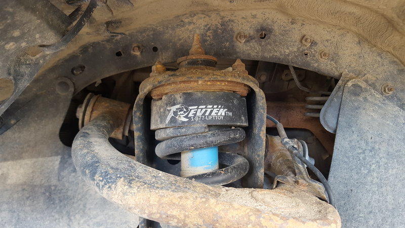

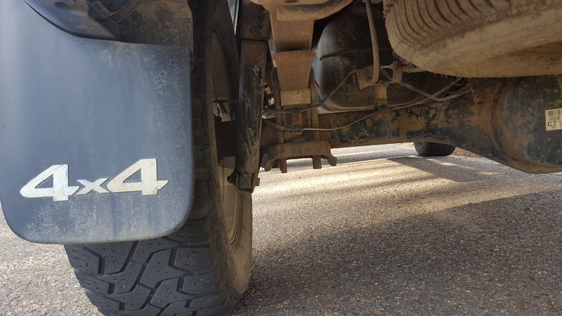

    Hi i recently bought this sexy tacoma from a used dealership and they didnt specify what size lift it had on it. I am trying to figure it out so i can throw some rims and bigger tires on her. Any help appreciated.

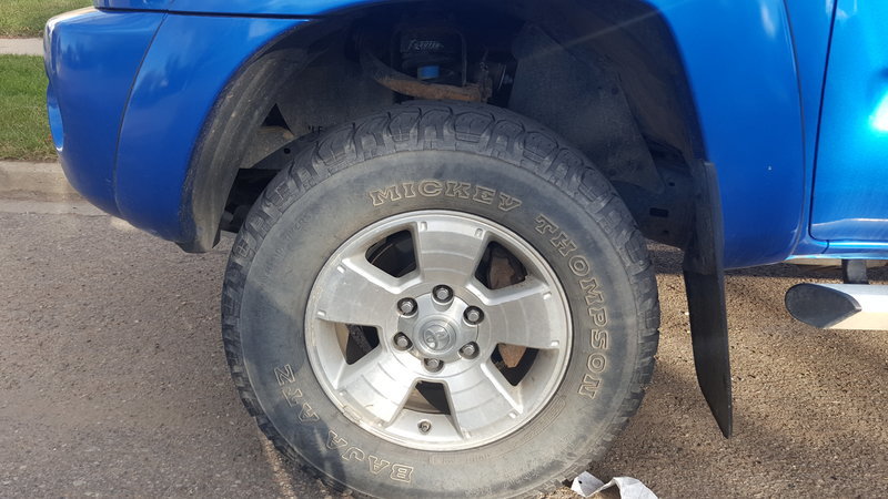

    Thanks for the quick response! So if i said i wanted to put on moto metal 18x10 rims wraped with a 33" open country... do you think they would fit decent?

    looks like revtek 426, but it is hard to tell what all is going on there without more detailed pics i.e. aal, diff drop? the front shocks look like stock blue bilsteins.

    You'll have rubbing but a bit of trimming would solve your problem

    Not sure as on the 18x10's as most would advise against such a large/wide wheel here, but 33's will fit with some trimming of plastic up front and maybe cmc when full lock. I would suggest upper control arms to keep your alignment in spec.

    That's most likely a 3" coil spacer and an 1.5"-2" block in the rear.. I ran 33's no problem on my truck when I had a similar lift. My wheels were a 16x9 with 4.5" back spacing...
    Be careful 12 and -24 are offset measurements, not back spacing. Your back spacing is the distance measured from the back lip of the rim to the mounting surface of the rim...
    Your offset is the distance from the center of the wheel measured to the mounting surface of the wheel.. Negative offset will give you a wider stance.
