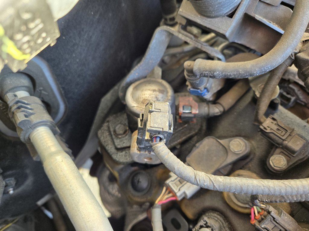

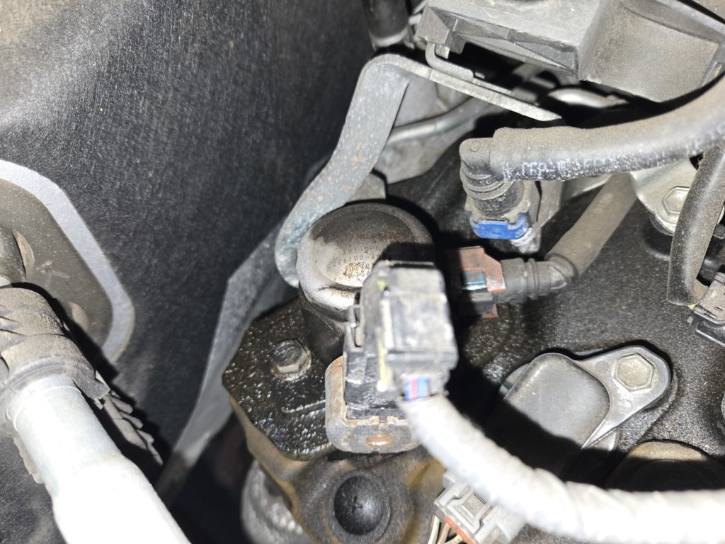

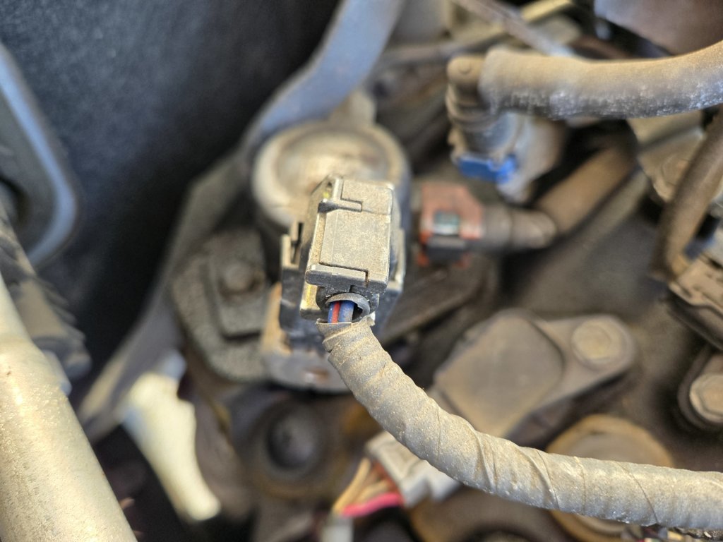

Help Identify leak in 2016

    Looks like your high pressure fuel pump is leaking. There is a service campaign on these and they are being replaced for free as long as the vehicle is within 10 years of the date of first use, unlimited mileage.
    See the customer support notice from Toyota at this link: https://static.nhtsa.gov/odi/tsbs/2023/MC-10236191-9999.pdf

    If it does not smell like fuel, most likely you need to replace a spacer gasket. Judging by a picture, this is the oil residue
    If you do smell the fuel, need a pump. FYI, a few month ago HPP was on a backorder.

    I wiped it this morning and it does not smell like gas. Looks like oil?

    It looks like oil, which should also off an oil smell. As mentioned in post 8, that component probably needs a gasket.
