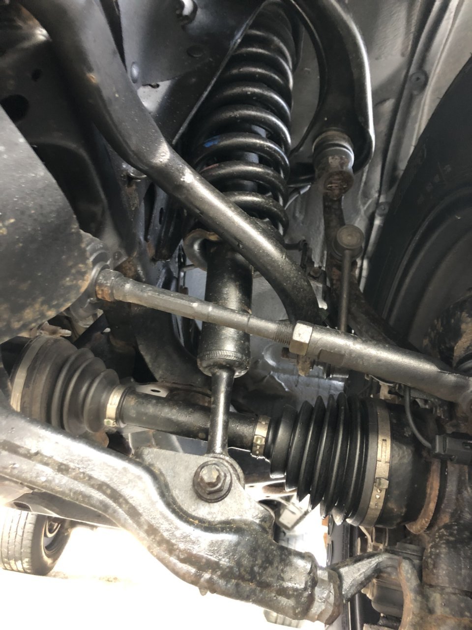

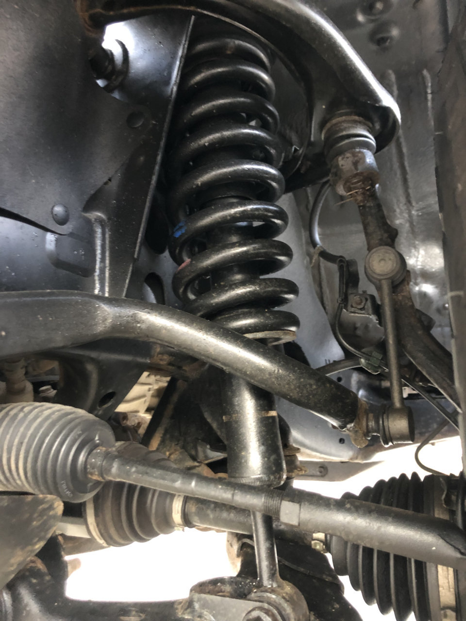

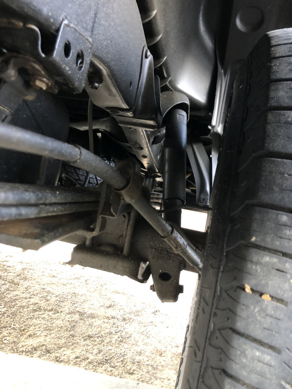

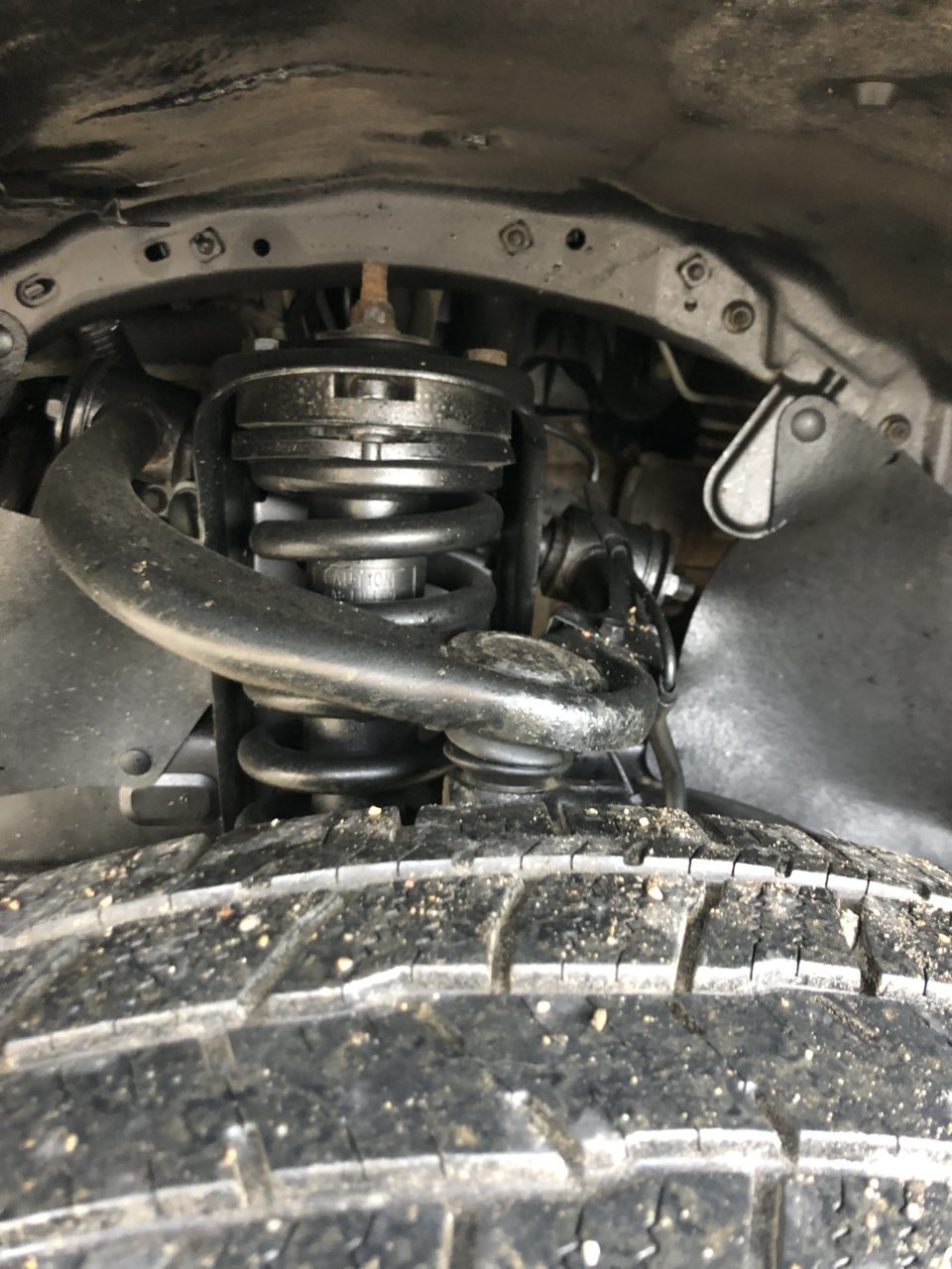

    Recently purchased a 2012 access cab Tacoma.
    It’s had a few mods wheels, exhaust, bumpers, etc.
    But I’m curious how much lift an what kind of suspension is under it.
    It’s especially difficult because all have been under coated or painted black.
    I’ve taken a few photos to see if anyone here with a more experienced eye can identify what I’ve got here.
    Thanks

    Sorry guys my mistake , I just assumed the pictures attached.
    Here you go ……

    Looks like factory Sport suspension off a 3rd Gen with a 2” level on the front. Hard to tell with everything being painted black but that’s no fancy suspension

    That's stock with a leveling kit/spacer on the front. Also your truck has a 2 leaf rear spring pack that has a Toyota recall on it.

    If the truck has lived in salt country, I'd be concerned about why all that stuff is slathered in black. Trying to hide something?
    A good exam of the frame might be in order.

    This right here.. Rattlecanning the undercarriage would be very concerning of an owner hiding rust prior to selling. That unpainted top rusted nut on the shock is a dead giveaway. If you are going to rattlecan to deceive a buyer, at least give it a 2nd look to make sure you didn't miss covering any exposed rust.
    Either way, removing and installing a new lift would be a pain in the @ss when dealing with rust.
