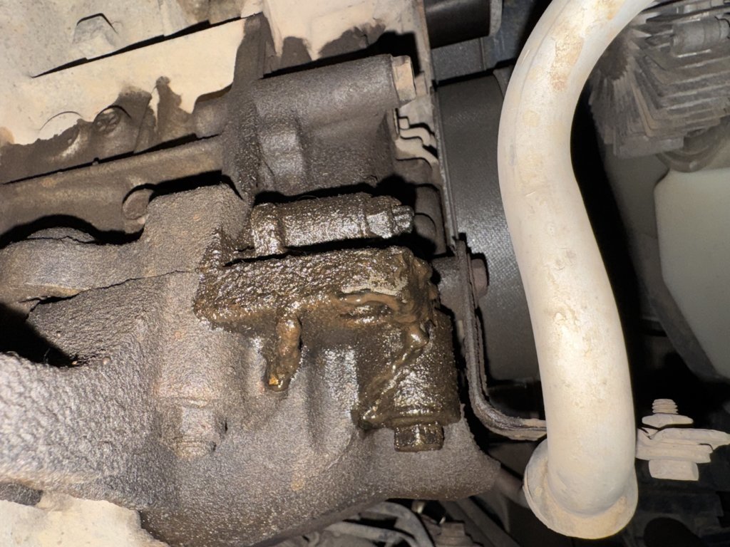

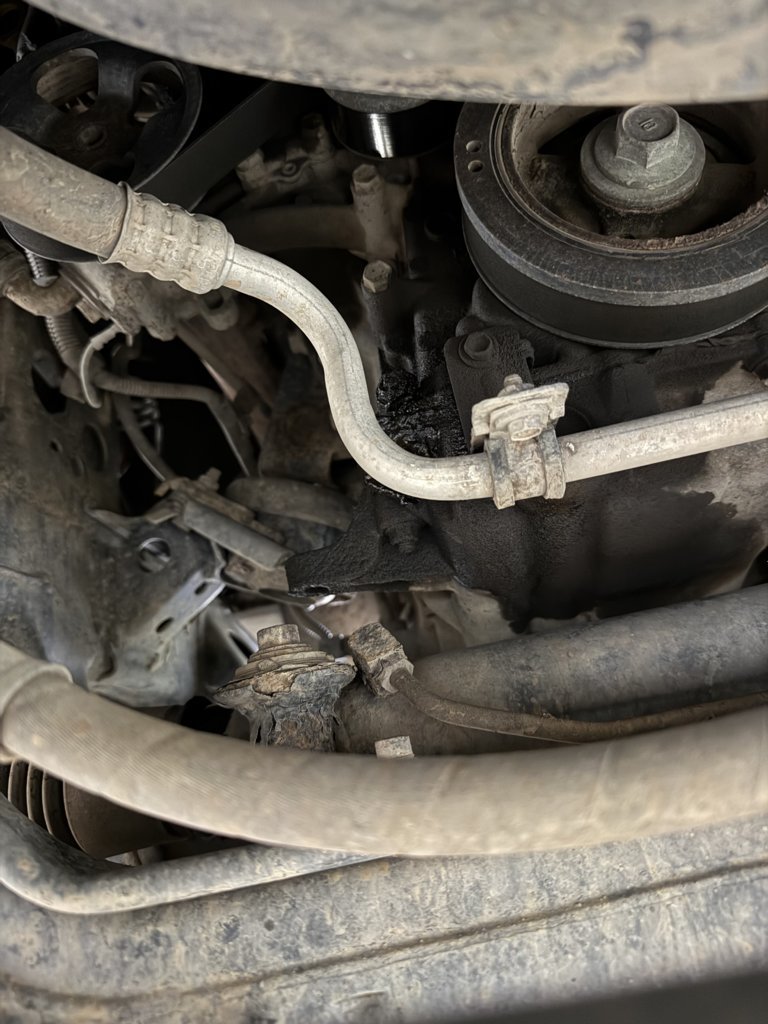

    Any idea what this leak may be and where it is coming from?
    Photos taken from front/passenger underside of engine bay

    Hard to tell it may be that upper oil pan or the timing cover. The timing cover seems to be a super common leak spot ( there are lots of forums about it) I would suggest cleaning it and seeing were it is coming from. Honestly doesn’t look like that bad of a leak.

    Looks like timing cover leak to me. Hard to say. I concur with @Owenhall -- if it's not dripping onto your driveway, it's not a big problem. If it is... easiest solution is a skid plate, to catch the drips. If that drips onto your driveway, and only then, would i consider fixing the timing cover.

    My timing cover has just a small black spot on it as well it’s very hard to see , it doesn’t really change so I’m not going to mess with it. I just keep an eye on it.
