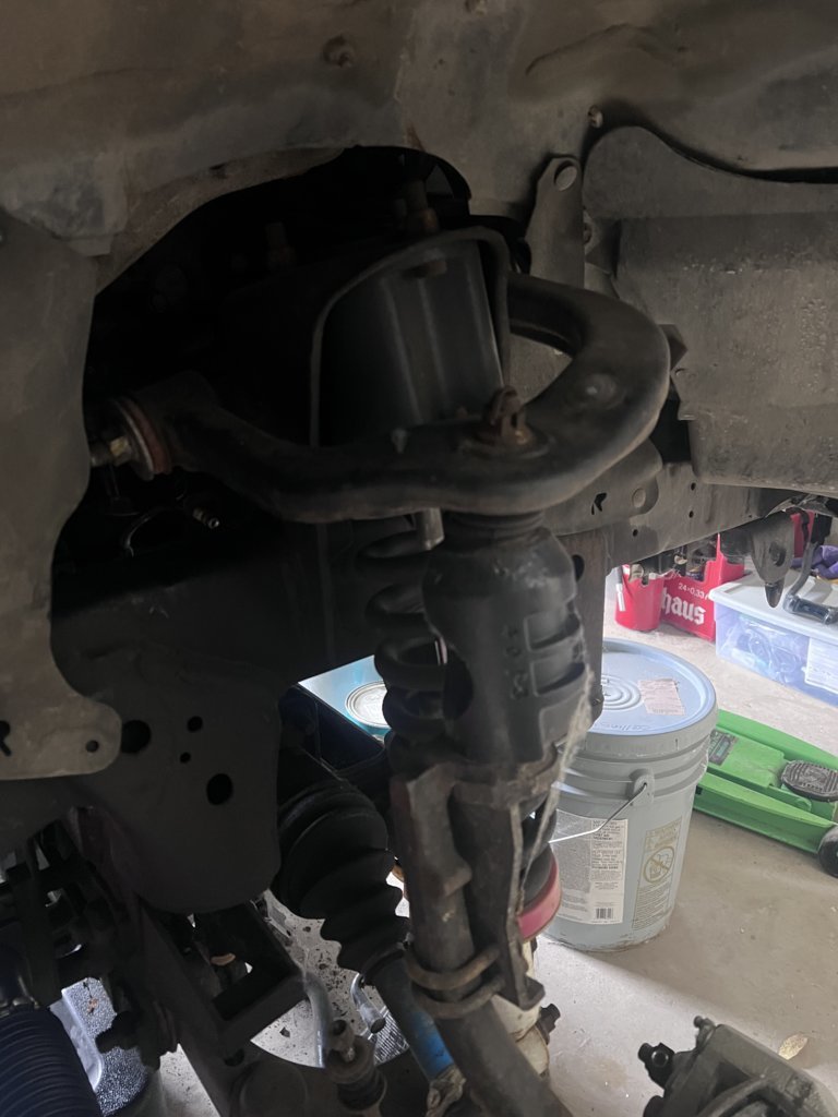

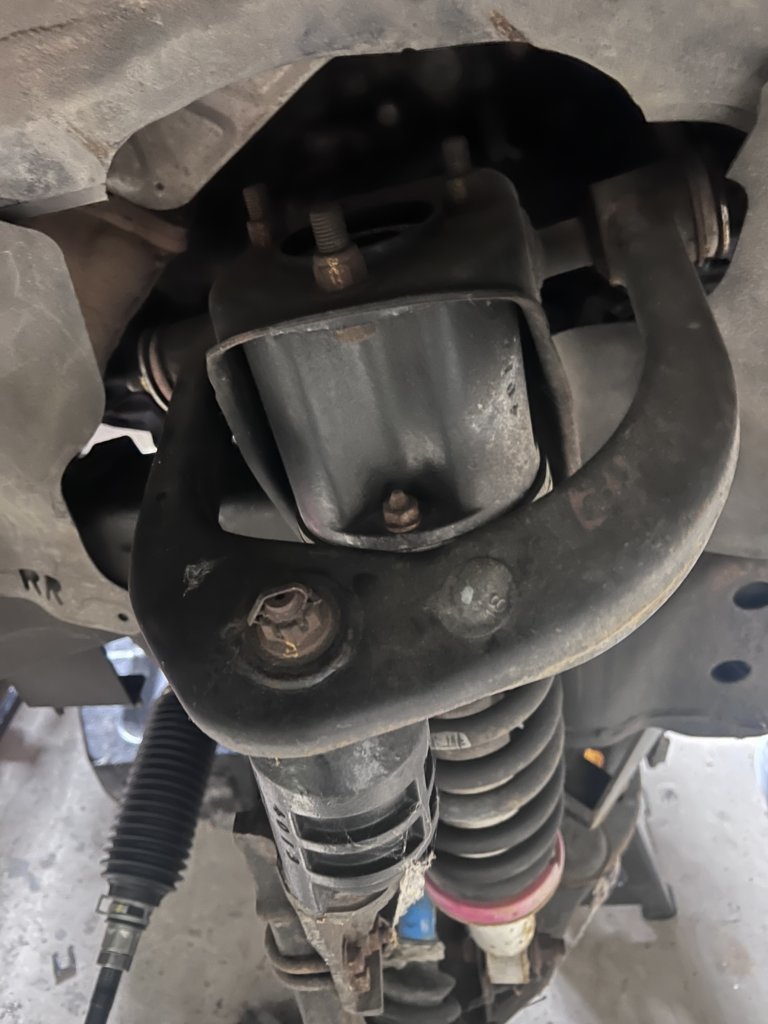

    Hello all,
    I’ve been lurking here for about a year after my wife’s 2000 4x4 snapped an LBJ and Batmobile’d the drivers side front wheel under the frame. I decided to fix it which had been as fun as it was a terrible idea.
    I have been contending with a suspension mod the previous owner installed and I am curious if anyone knows what it is, if it is safe, and should I delete it. My wife likes it, but if it is sketchy, I’ll get rid of it.
    Thanks for the help.
    Here is the passenger side. I left it almost as it was on the day of the accident:

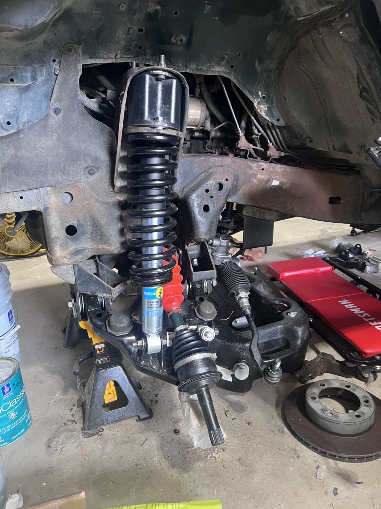

    Here is the drivers side as I’m installing new components:

    I think your wife likes the extra 4 inches. That’s a 4” drop bracket lift. Unfortunately can’t undo it without welding in the stock brackets that were cut out to install that lift.

    Looks like the bracket is just bolted in. That explains why the OEM steering rack bolts and steering rod coupler didn’t fit…it’s all making sense now.
    Sure does make it a bitch installing UBJs…

    After what I’ve been through for a $150 LBJ, you better believe I’m replacing all the ball joints…and everything else on the front end: upper and lower a-arms, steering rack, OTRE’s, etc. Even upgraded to Tundra brakes up front cause I couldn’t find OEM Taco calipers.

    So what you listed here in this post is the rear shocks, and that's another separate thing to consider. I'd bet you can make those 5100s on the front work, by removing the drop bracket, the huge spacer above the shocks, and that sketchy AF looking steering knuckle coupler/spacer thing-a-ma-jig.
    And FWIW, I'd put your foot down and tell the wifey those extra 4" ain't worth the headache. That lift will likely wear out all of the brand new fresh parts you just bought quite quickly.

    It's almost certainly the 4" ProComp drop bracket lift. Doesn't look like ProComp even lists the 1st gen version on their website anymore, but did find a picture here:
    Pro Comp 4" Lift Kit for 1996-2004 Toyota Tacoma

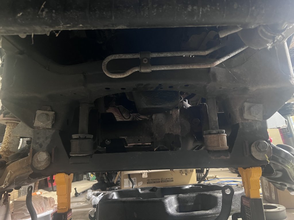

    Re "I'll remove it"... good luck, you need access to a donor frame, and fab skills to remove an intact control arm sub frame and weld it into your truck. It's not impossible, but a lot of effort.

    That kit destroys new parts very quickly.
    You will need a new cross member welded in if you decide to remove it. Everything else is pretty simple to swap out.

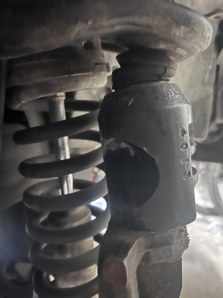

    I’d want that shit outa there as well, lots of weak links, just the drop spacer on the front diff mount brackets look sketchy as shit.
    One thing that you might be able to do is find a rusted frame that’s being/been junked and see if the front subframe is in decent shape. A lot of times the rusted out frames are in the rear since that’s where the tires are spraying water/salt

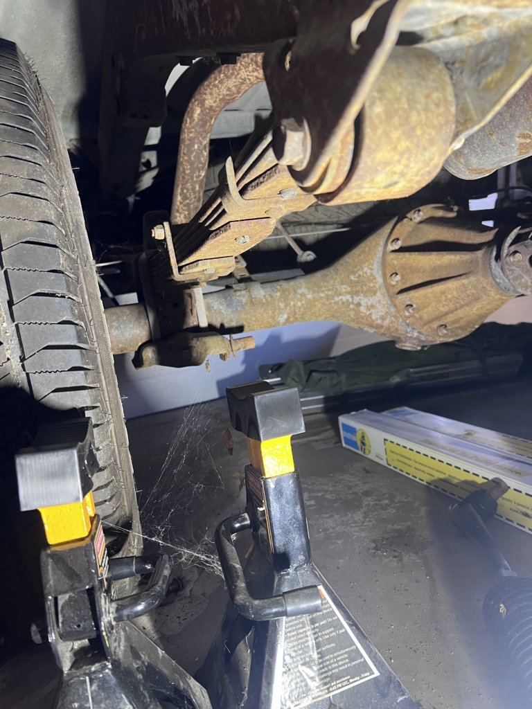

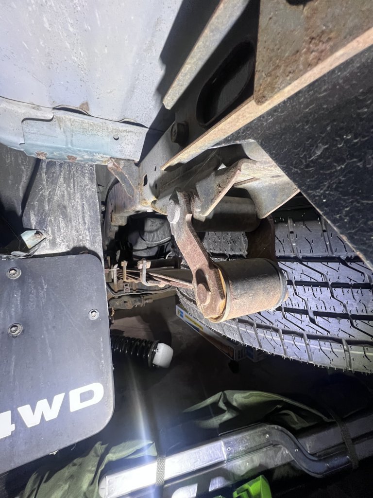

    Apologies for the delay in responding, thanks all for your inputs.
    That steering knuckle is sketchy AF, as the kids say.
    I’ll dig in deeper to see what was cut before I pull it out, thanks for the tip on the brand.

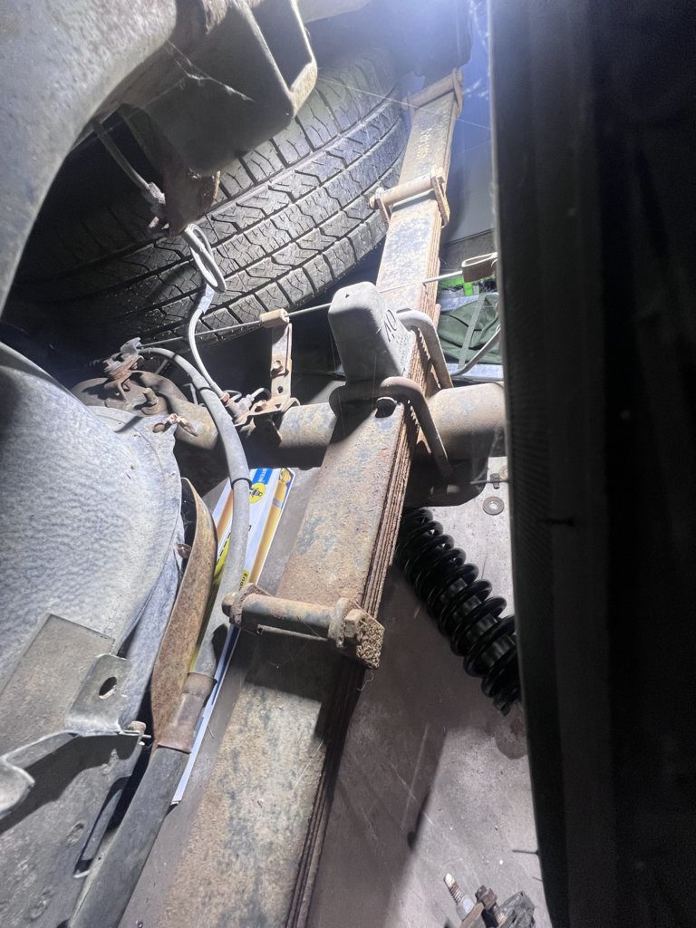

    Finally some pics of the rear, sorry they’re terrible. Look like this motherfucker didn’t do anything to the back, but I stand ready to be corrected for missing some super sketchy and cheap mod.

    The rear springs look pretty worn out. Flat and twisted. Might want to replace those too, or get them re arched

    1995.5 White Tacoma 4x4
    Does the truck sit level? I expected to see a big 3+" block back there

    I did as well. I think he's actually got an aftermarket leaf pack or add-a-leaf, which is a much better rear lift solution than one would expect from someone who'd lift the front in the way they did

    I'm not quite sure you understand what you have with a drop bracket lift. There isn't really a "pull it out" option without having a donor frame and fabrication ability. I also don't think it's as sketchy as you're making it out to be. It's been on the truck for awhile without anything terrible happening. Drop bracket lifts just aren't as desirable for several reasons. For a 4" - 6" lift, you're just not gaining anything except for a higher center of gravity. The ground clearance under the drop bracket is the same or worse than a stock truck.
    100% aftermarket leaf springs, but I can't name 'em off the top of my head. Looks to be a model number at the rear of the drivers side leaf spring that would identify them. If they're not too rusted, they would be probably worth looking into rearching them vs throwing them away.
