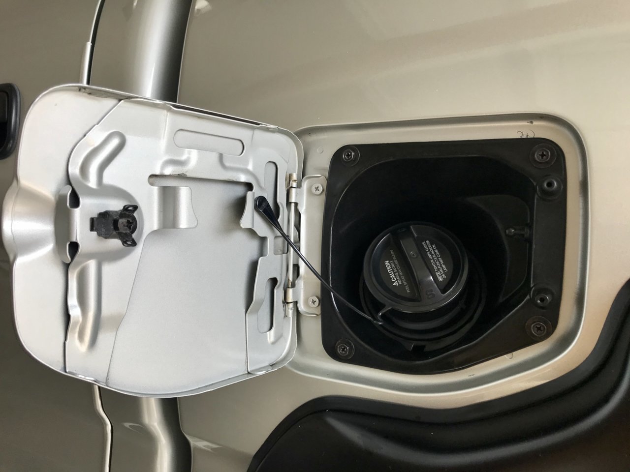

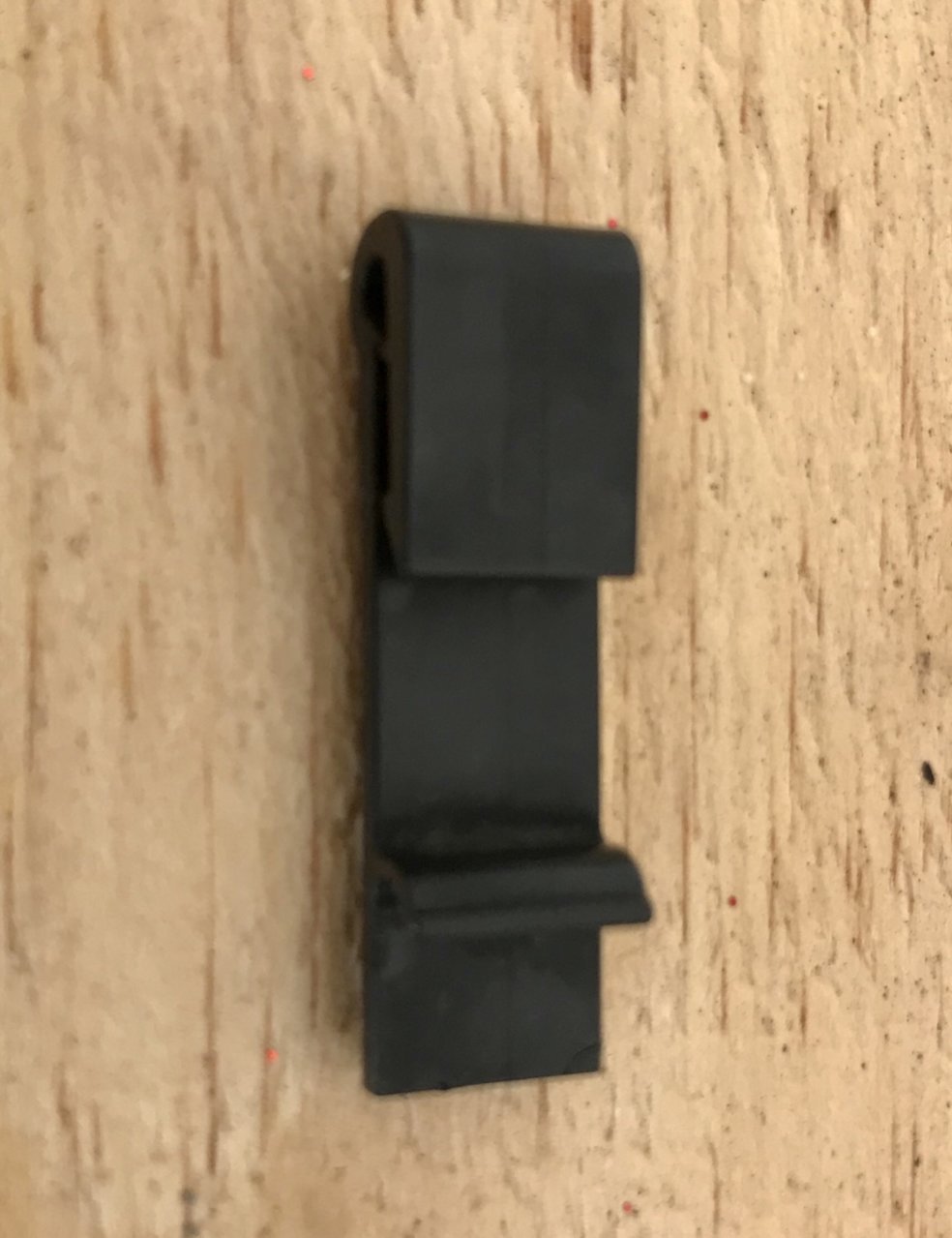

    The black plastic piece in the picture below fell out of the gas cover when I opened to get gas. Will someone please post a picture of their gas cap cover so I see where this part goes. Much appreciated!

    Its a fuel door stopper. Toyota part number 77358-35010. It keeps your fuel door from opening too wide. Check on this you tube video on how to put it back in. But disregard the clip part in the video. Its only for vehicles that have a fuel door latch.
    https://www.youtube.com/watch?v=ft3USRKew_c

    Thank you StockTRD! Exactly what I need.
