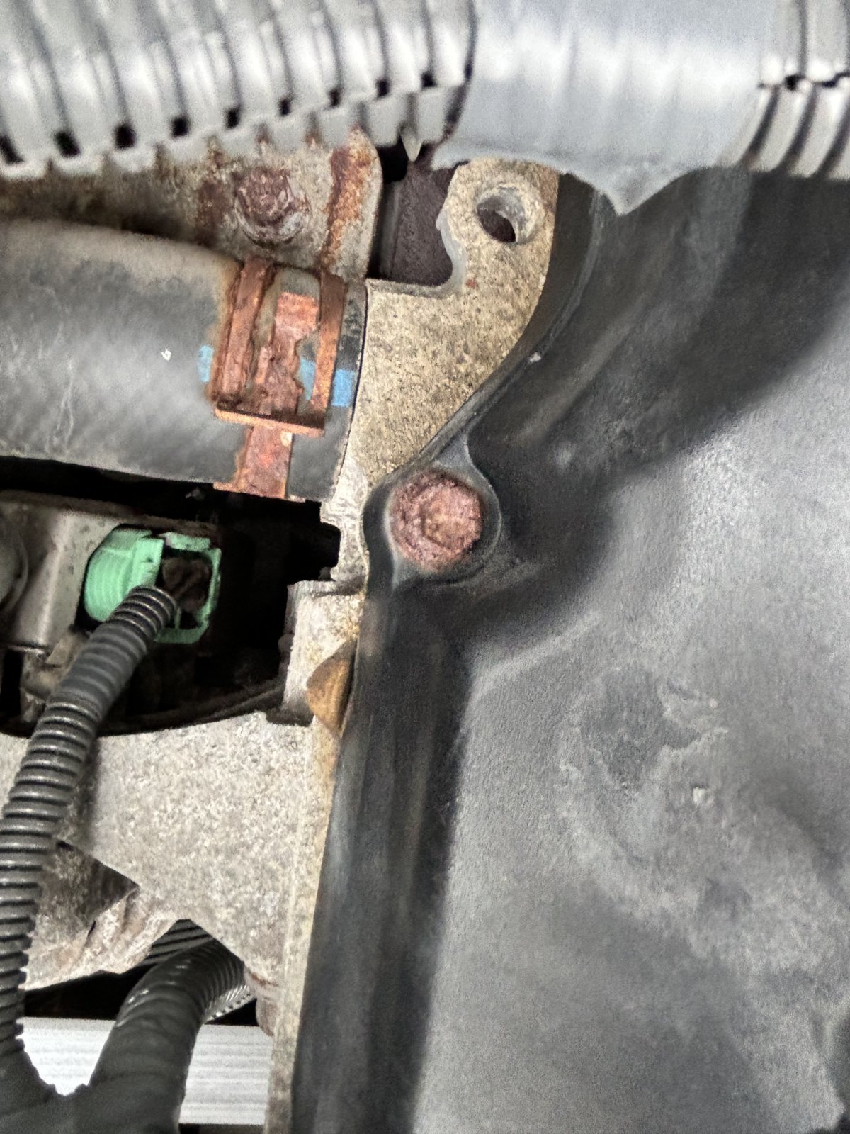

    2010 regular cab 2.7 manual

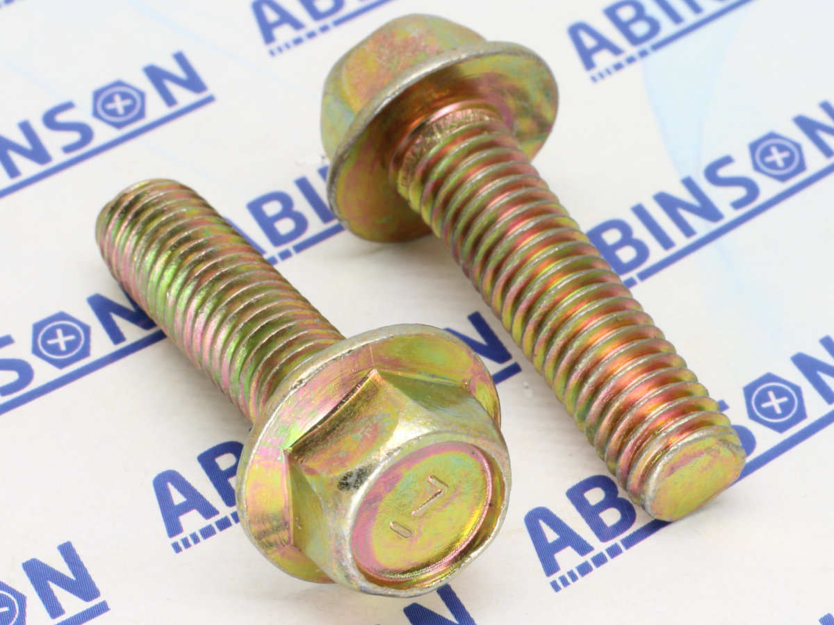

    Im on a journey to replace all the clamps/fasteners in this engine bay with zinc hardware and im stuck on valve cover bolts. Does anyone know where i can find detailed info on the oem specs of this bolt? Id really like to be sure of what particular strength rating it should be, loctite/torque specs, length and pitch size… so far ive deduced 10mm and 1.0 pitch… flanged? Flat and lock? idk these things are so rusted
    Maybe im being excessive and should just use whatever bolts fit but im a little insane
    any help appreciated bros

    have you tried loosening that bolt at all? I am trying desperately to recall the brand spray I use for such things but its escaping me. Almost driving me mad.

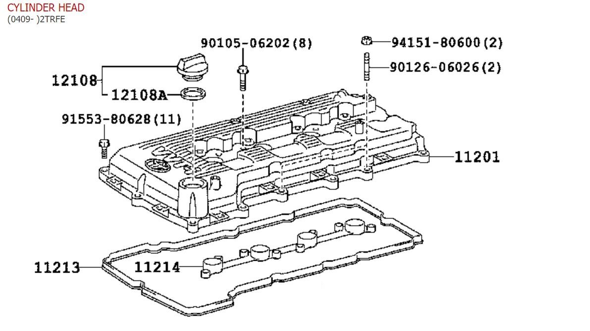

    91553-80628

    no i havent even touched it yet. Last thing i need is a bolt snapped off in the head LOL. I definitely plan on using kroil or something for a few days beforehand.

    wow i didnt even realize that back one was a stud and nut… good to know. I’ll likely just buy these oem ones… but those pretty yellow zinc ones though ;..(

    holding plastic/composite valve cover, definitely grade 12.9 :p Dang 2010 and they look like that, should get some fluid film or crown coating or something on that truck. The FSM has all you need for torque values and can be found out there.
