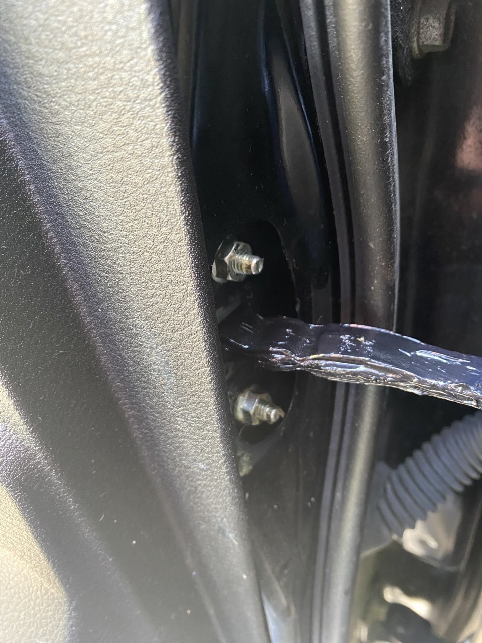

    Hi, I own a 2017 Double cab Taco and started noticing this “clicking” noise on my driver side door every time I open or shut it. To me it sounds like “metal is hitting on metal”. Haven’t done any modifications to the fenders, door, no accident etc.
    I created a little sound clip and I’m hoping you guys would be able to help me identify this noise. Thank you.

    I don't hear a squeaking sound - more like a "click."
    Have you tried lubricating the mechanism with the detents that hold the door at various degrees of open?

    Is all the hardware tight on the mechanisms? I also hear it as more of a clicking, which sometimes happens when loose hardware allows linkages and mechanisms to shift slightly. In other words, the bolts are a touch loose and things have a little play

    I’ll try tightening everything up. Thank you

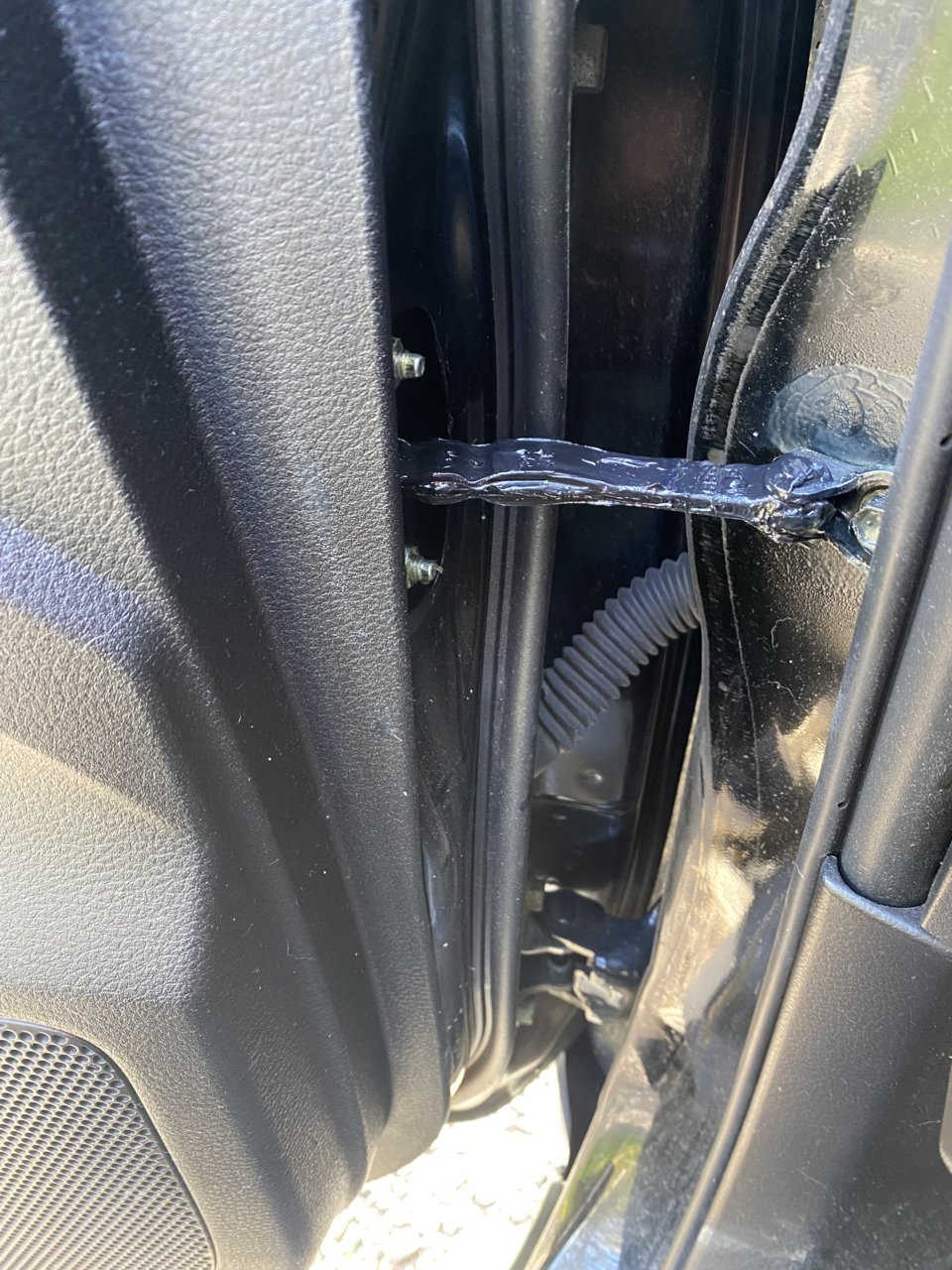

    Did anyone solve this? My ‘21 is now doing this same thing. Thanks

    These 2 gold colored nuts were very loose. Fixed the issue!
