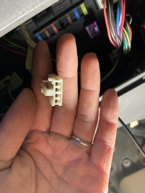

    Any help identifying this connector? Found behind one of the switch covers on the drivers side. 2005 ACLB base model.

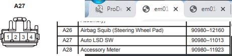

    Wire colors would confirm but looking at the connector list looks like Auto LSD switch connector, it would only be equipped on models with VSC which was a rare option on early 2nd gens.

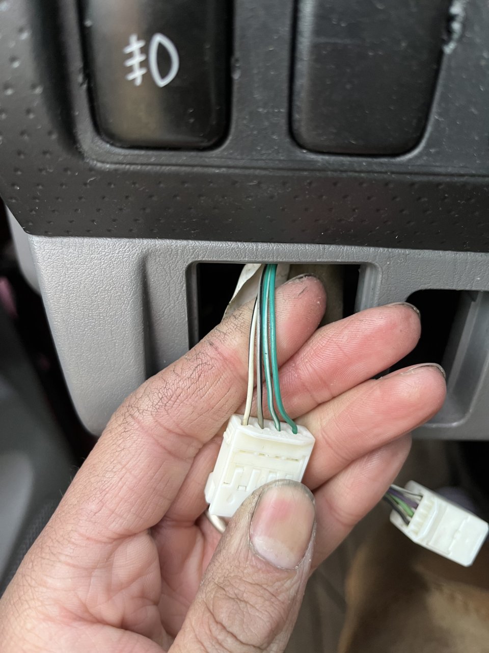

    Don't think so, none of the wires on that connector are powered except for the Green one and it only is when the Tail/Headlights are on.
    Assuming it's indeed the Auto LSD Connector here's the pinout:
    Pin 1 Green: Illumination Power
    Pin 2 Green/White: Illumination Ground
    Pin 3 Green/Black: Auto LSD Switch Signal
    Pin 4 White/Black: Constant Ground

    Confirmed the colors of the wire. Thank you.
