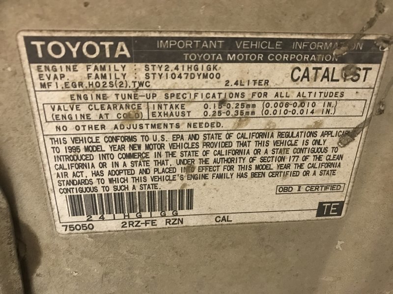

    I've searched but couldn't find help elsewhere. I apologize if this has been discussed before...if so please direct me to a post that describes this and I'll try and remove this to reduce clutter on the forum.
    I am wanting to know if my assumption is correct that I have the 2RZ-FE engine in my truck. The placard in the drivers door area says "3/95" and the placard under the hood looks like this, with "2RZ-FE" written at the bottom (attempting to post picture):

  2. Apr 25, 2017 at 9:44 PM
    DrZ
    DrZ Well-Known Member
    Dec 14, 2014
    #144262
    1,459
    Mesa, AZ
    96 2.4L 5-speed
    It looks like a 2RZ-FE 2.4L from the placard. A picture of the engine might help.
    You don't need to pull the head to check or adjust valve clearances. You just need to take the valve cover off. It's not too hard to just check the clearances, and the shim over bucket design usually takes a while to go out of spec, at least 100K+ miles or sometimes 200K+ miles.

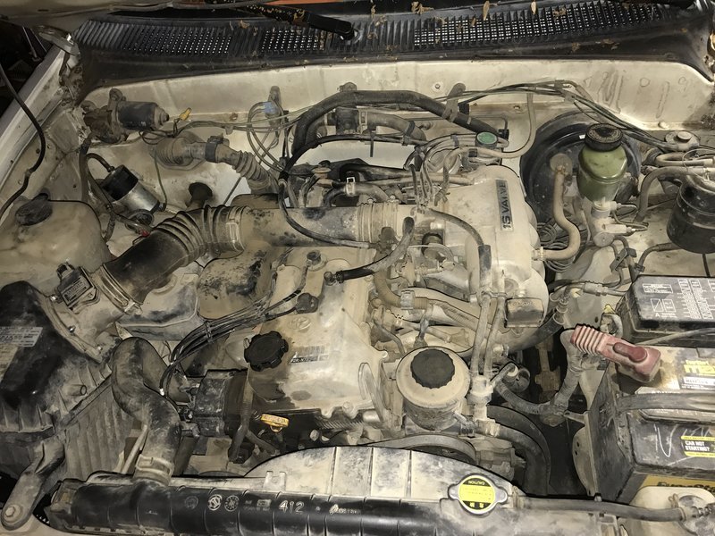

    thanks doc...head, valve cover, what's the difference? I meant to say valve cover but...Here's a picture of my engine and some 22 year old dirt and grime. Looks like I found a sticker that was covered with dirt on the head says 2RZ-N73 so this is starting to confirm my suspicions.

    To check the valve clearance all you need is some feeler gauges.
    To adjust the clearance you have to check the clearance, then pull out the existing shim and measure it with a caliper. Then install a new shim that will give you the correct clearance. The problem is that you won't know what shim you need until you pull the existing one. You will most likely have to order them through the dealer. You can call them before hand and see if they have any in stock, but it's doubtful. There are 8 on the exhaust and 8 on the intake. The exhaust ones tend to get tight over time.
