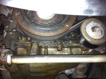

    Ok, so this evening after parking my truck in the parking garage for the night, I decided to climb underneath and have a look around. I noticed some wet spots on my skid plates so I decided to take them off and look for the cause. As soon as I removed the front skid, I noticed a large oil leak on the front of the engine. I have no idea where it's coming from but it looks like its coming from behind the crankshaft pulley or somewhere in that area. Im thinking its the crankshaft front oil seal, but i dont know enough about these engines to be certain. Im away at school right now, or else id get my dad out here to look at it. Please, if anyone can enlighten me or help me in anyway it would be greatly appreciated. Here are some pics that I took.

    The timing chain cover was known to have a leak on some vehicles. That could be it.

    Yup I had the same problem with my old 06, the timing chain cover had a serious leak and was covered under warranty, you definitely want to get that fixed asap

    How do I know it's the timing chain cover and not the crankshaft front seal? Are there any specifics to look for?

    Where does the leak start? If there is oil about the crank seal, its probably not that.
    Oil follows gravity.

    The leak literally starts right behind the crankshaft pulley, thats why i think its the crank seal. Oil follows gravity, that's good to know:D

    Steam clean that BAMF then look after 2 miles or so.

    Think positive, crankshaft seal is easier to fix then timing chain cover. :D

    Try to take better pictures of the area. Maybe few from top of the engine (pass side and driver side) Right now that looks like crankshaft seal which is fairly easy to replace. Hardest part is taking crankshaft bolt out and tightening to spec after replacing. Seal I think is like $50 You may want to replace belt and check idlers and tension er while you there.
    One word of coution that crankshaft bolt needs to be tightened to spec

    Last year I had my truck in at the dealership for an oil leak from the front crankshaft oil seal. Not nearly as messy as the OP's, but oil was dripping down the front of the block right underneath the pulley. I drove several thousand km with the problem without issue. Discovered at about 94500, fixed at 98200
    Work order from the dealership shows 90311-A0005 as the oil seal and 13470-0P010 as the crankshaft pulley. Apparently the pulley is a better-fitting part.
    My truck is an '09 SR5 but I hope you can use what I found to fix your leak.
