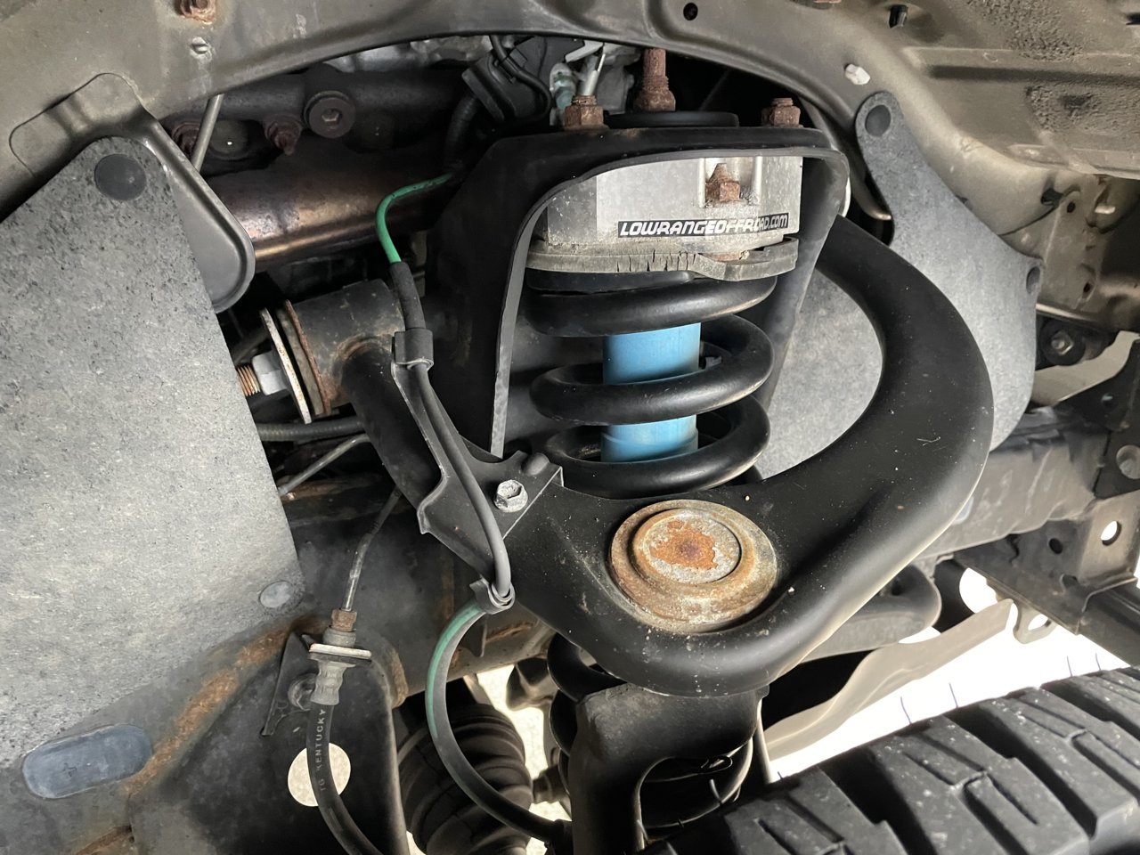

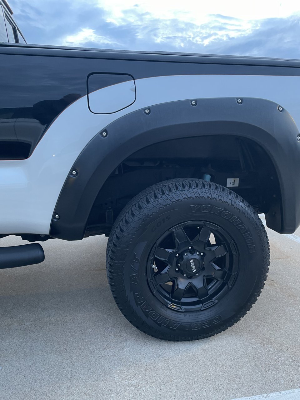

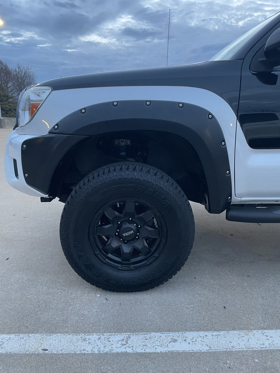

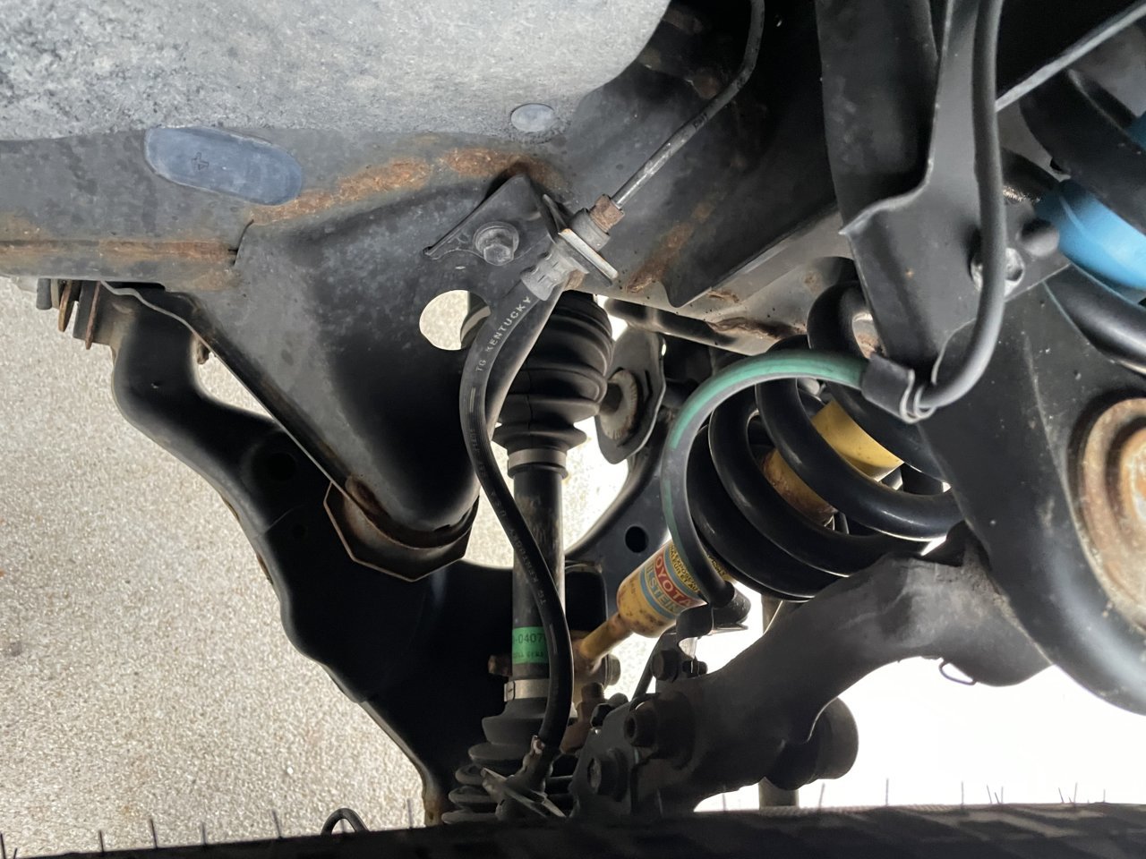

    Need help identifying how much lift was put on this truck/what type. Tires are 275/70/16. Has spacers on top of the front shocks that say lowrangeoffroad.com

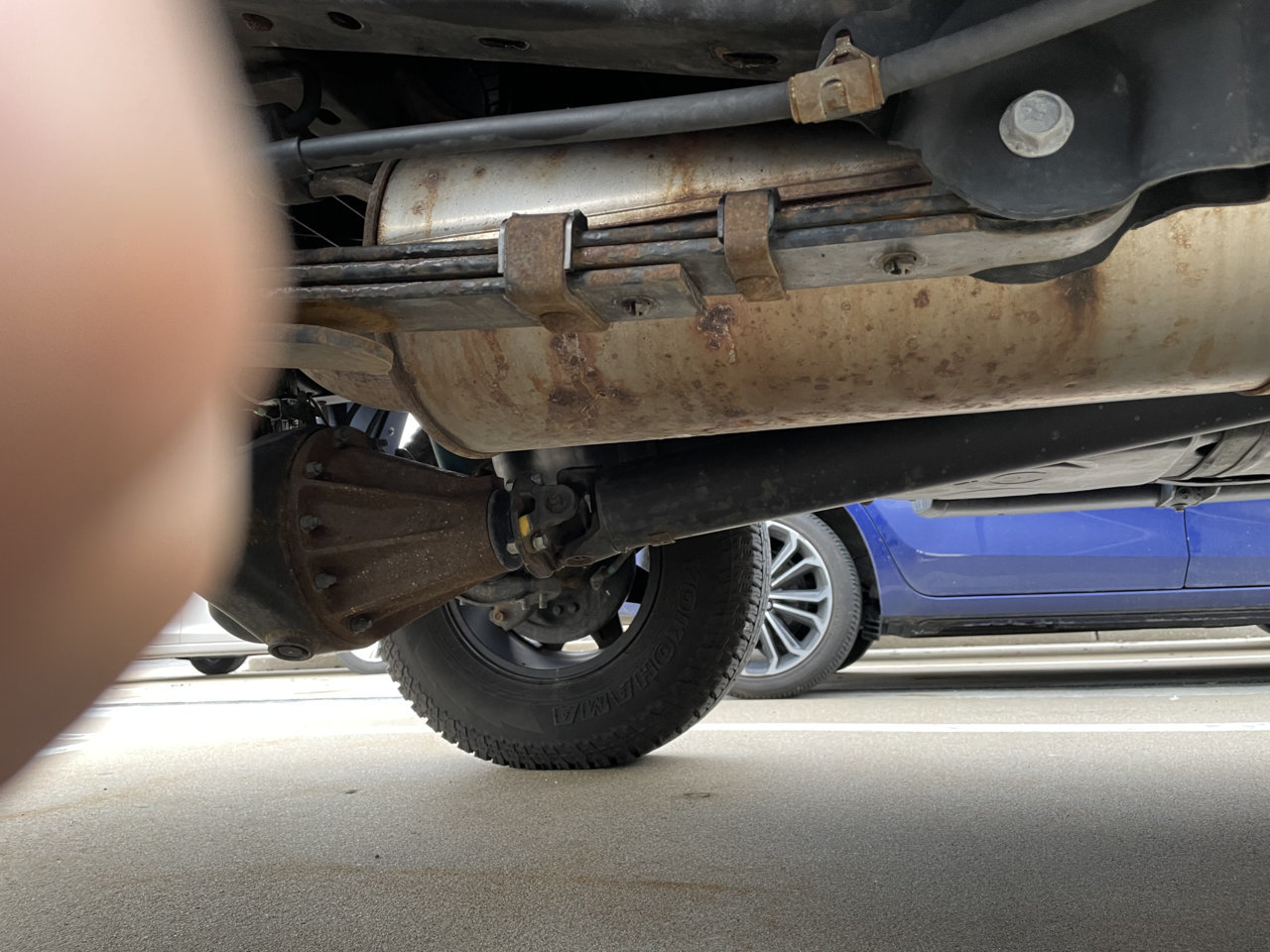

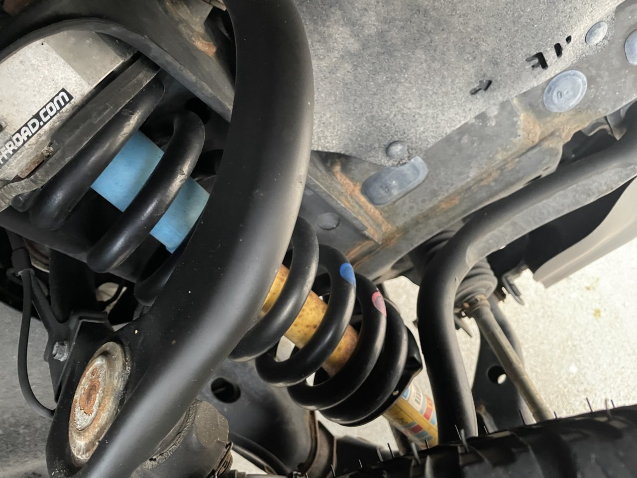

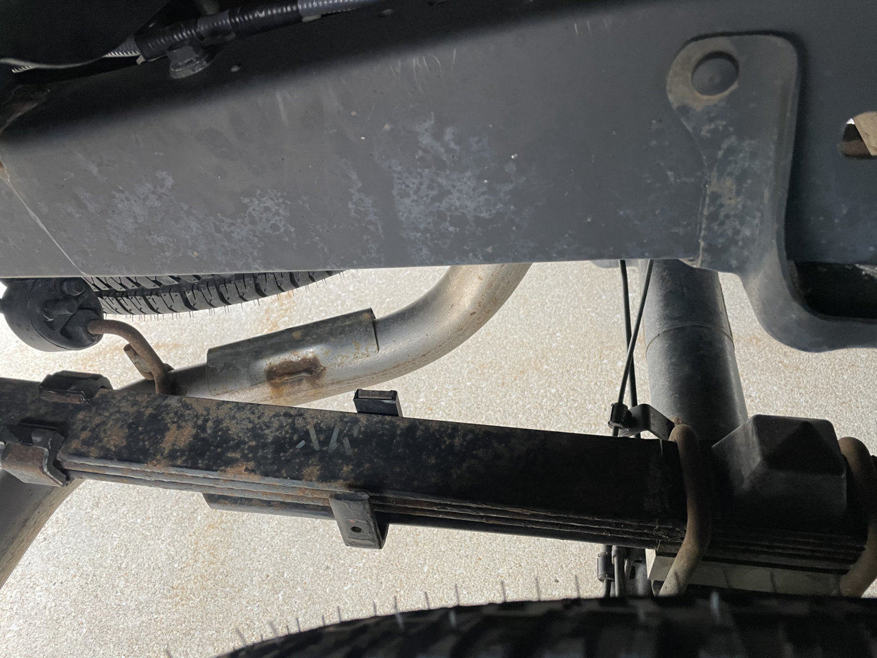

    If you can, please take a picture of your front shock from top to bottom and your leaf spring where it attaches to your rear axle. We would be able to tell more from those types of pictures. Please use the flash.

    more pics

    So that is a low range off road lift/leveling kit. It is a 3 inch in the front and a 1 inch lift in the rear.

    Thanks. Shocks look like they could use updated anyways. So might update with a suspension lift.
