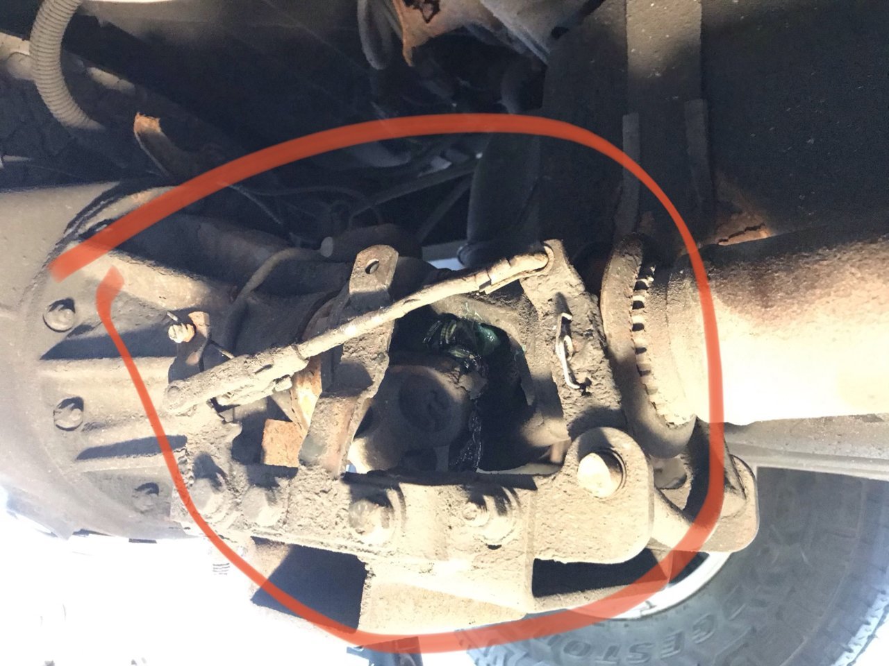

    12EAD6DD-D986-4F2D-82BC-6AAEE9B5965F.jpg Hi there, first time post. Can someone help identify this part? It’s right in front of the rear diff.
  2. Sep 15, 2020 at 12:30 PM
    ROAD DOG
    ROAD DOG Well-Known Member
    Nov 4, 2019
    #309830
    2,212
    2019 I4 WHITE SR PRERUNNER
    FEW
    on what vehicle??

    Parking brake?

    It’s a driveline disconnect for towing the truck behind a motorhome.

    Cool! I see the hoop now. Never seen nor heard of it.

    Wow, look at that rust

    2005 access cab 4L v6 4x4

    This happens when you live in Canada and drive in the winter. It’s and 05 min you.

    If you flat tow your Tacoma behind an RV they're nice to have. Otherwise, remove it, clean it up, sell it and get a real driveline for the truck. I have one for my 4Runner. I swap drive lines for trips but once I'm home I put the stock one back in.

    I would have never gotten that! Nice.
