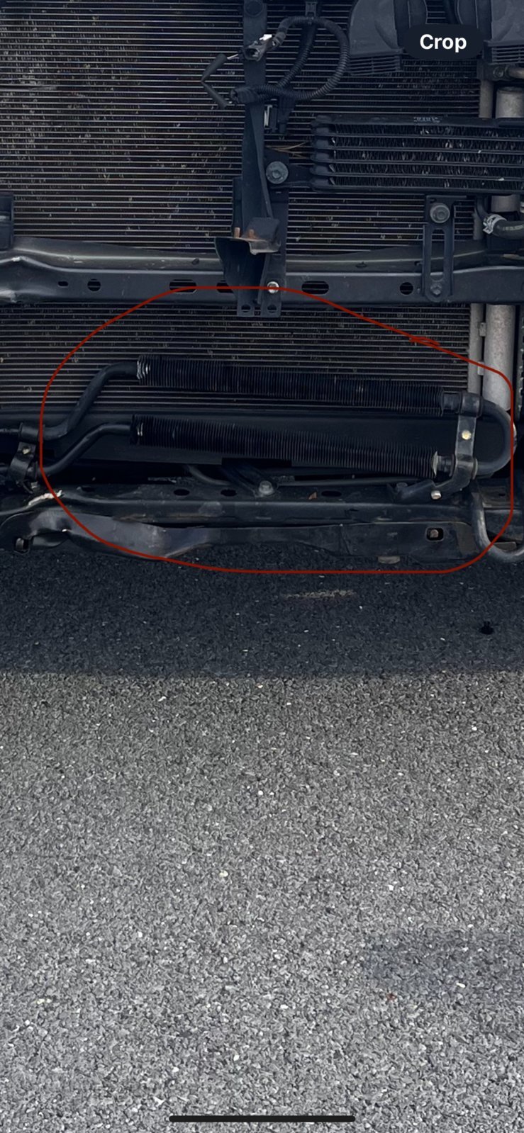

    Hey guys I am new here to this forum, but I wanted to reach out and see if anyone could help me identify what this part is? I had tried to find a part number somewhere on it and couldn't, furthermore I tried to find diagrams but couldn't find anything that looked similar. I was hoping someone more knowledgeable could help.
    Thank you for any help/advice!

    looks like a aftermarket oil or trans oil cooler what year is your Taco ?

    its a 2017 Toyota Tacoma SR V6. What threw me off was that I couldn't find anything that looked like this online, I might just be looking in the wrong places.

    OEM Power Steering Cooler.

    Yep……power steering cooler

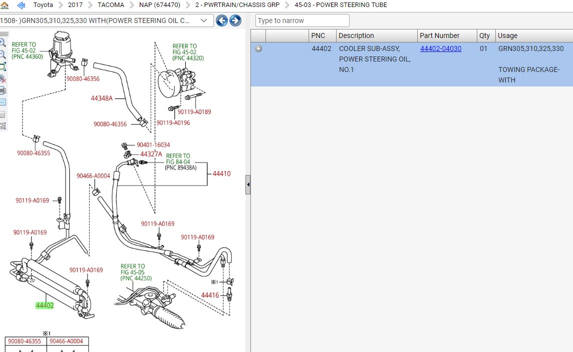

    $651 list price.
    44402-04030
