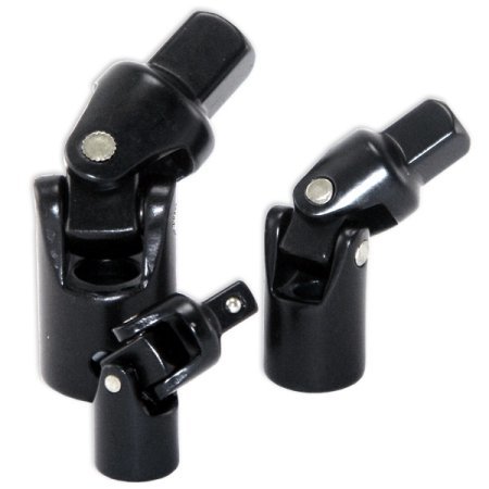

    Have you tried a swivel socket extention tough to tell in the pic If theres enough room!

    yep. the swivel is long enough that it hits the tube and then the socket no longer sits square and twists off when any force is applied

    the knuckle joint or any extension will hit the crossover tube and keep the socket from sitting square, then it twists off. Maybe I can throw a zip tie around the socket/tube to hold it in place while I put torque on it but I doubt it.

    Just a couple things
