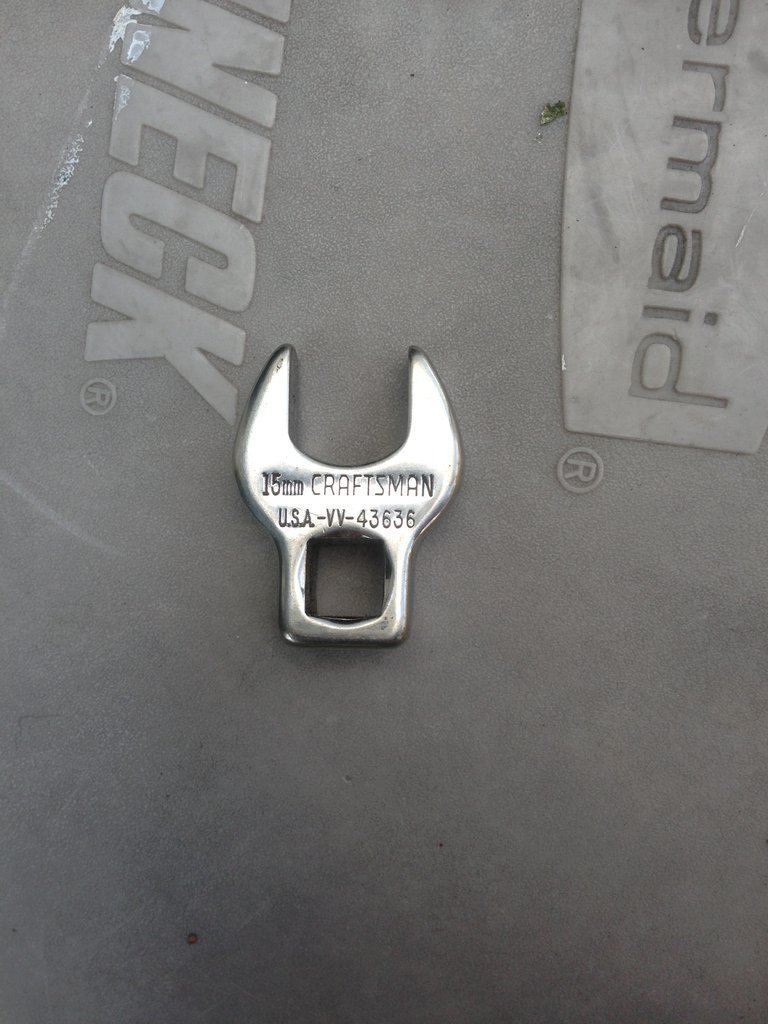

    How about one of these "crow's foot" wrenches??IMG_0611.jpg There was a bolt on an old Isuzu engine that required one of these. Haven't needed it since, but still in the tool box!
    scottalot and 16Tacos like this.

    Hmmm that might work too
