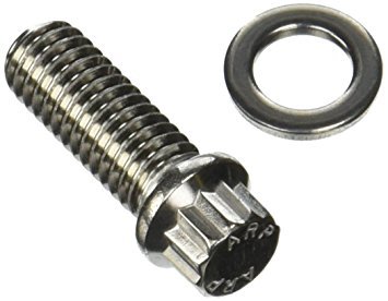

    I think I'd replace the stud with this bolt. God damn the issues with after market...

    There's a Fastenal by my office so I'm going to try running by there during lunch sometime this week to pick up a new set of the 12pt socket cap bolts. Since I have to go to Ace to exchange what I bought I think I'm going to return it because the diameter was slightly smaller that the bolts that came with the header.

    5,285
    hope they have something that can withstand the heat.
