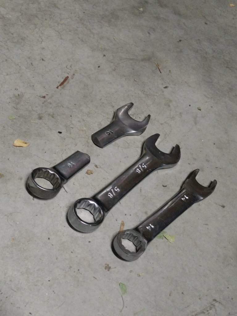

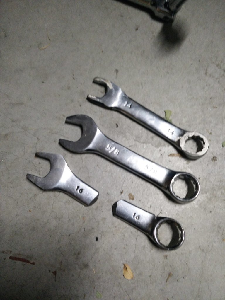

    I ended up grinding the shit out of the open ends of the stubby 14mm and 16mm wrenches I had and ended up cutting the 16mm in half. Finally got the old bolt out and replaced with the 12 point one, which was a breeze to tighten :amen:

    Can you post pics of how much you ground down the wrenches?

    Untouched 5/8" wrench in the middle for reference.IMG_20170831_233108.jpg IMG_20170831_233052.jpg
