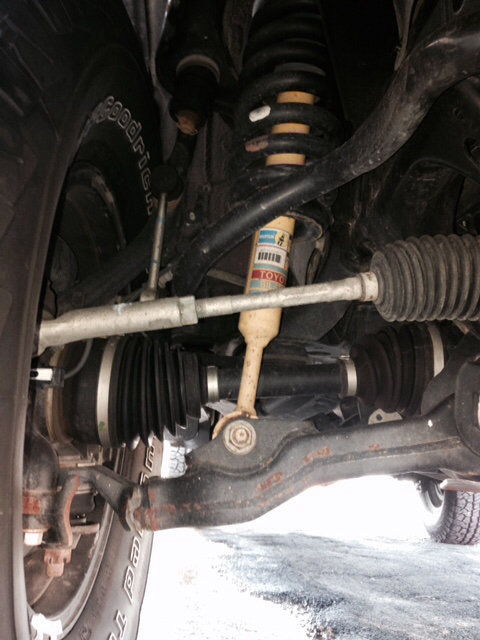

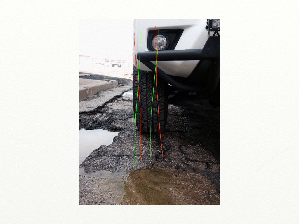

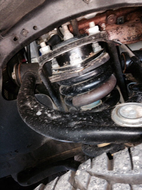

    Photo above shows what I think to be an issue...from the passenger side wheel looks a little tilted in. The other doesn't. Hard to tell in the photos but more apparent in person. Red represents what it looks like and green is what I think it should be or closer to.
    Maybe everything is stock except for tires? The ride is little rough so I assumed the suspension had been messed with...maybe just tires (BFG rugged terrain 285's)

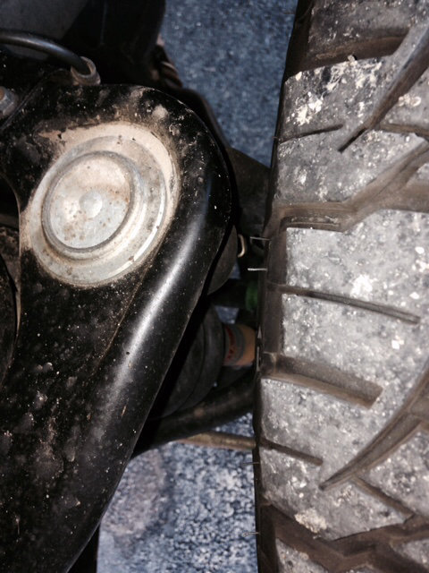

    Also, look how close the upper arm control is to the tire, it has marks where it rubs or maybe rubbed at some point.

    Some flags and center console divider... lots of things on the wanted list.
    You have a spacer lift. It's the cheapest type of lift you can get, and made for people who mostly street there trucks. Yes, people offroad them, but sometimes it ends up bad.
    Without seeing the rear (leaf springs) I am sure you have a small block back there between the axle and the springs.
    Are you looking to upgrade? What is your price point? If you want a shell on the back, most would recommend new springs that will hold the extra weight for a long period of time.

    If you want to keep it inexpensive... look up Bilstein 5100's. Set it at 2.5" or so using stock coils. Find an AAL for the rear. You will be set, and better than your spacers.

    Also, any advice on the wheel angle from the first pic I posted?

    Alignment might be off. After you do your suspension you will need an alignment. My recommendation would be to get it all done in a day or two. Or take it to a shop to do it if you aren't mechanically inclined. If you stick with a 3" lift though, you might want to consider getting new UCA's.
