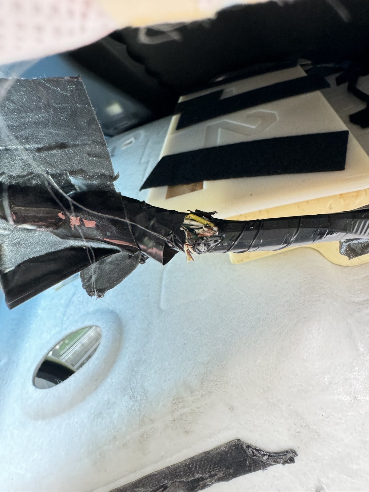

    Found the bastard…damn. I feel like an idiot, but I used drill bit collars and still managed to bust through the wiring harness. Feels like Prinsu could be a bit more forewarning about this harness being directly beneath this front bolt mounting holes. They do say not to drill too deep, but no where near the warning needed. I would have been WAY more careful if I’d known.
    Anyways, not that big a deal to access, but let’s see if I have enough length to fix this.

    Don't beat yourself up about it, you aren't the 1st person to do it and won't be the last :thumbsup:

    It happens. Not the end of the world.
    At least you can get to it kind of easily.
    It'll will be fine. Crimp them back together and call it a day.

    I’ve bolted some stuff to it *lists cool stuff here*
    Almost center punched it, impressive shot :hattip:

    Haha surprisingly clean cuts. Expected it to be shredded

    Ahh errant drill bits, so fun! well I guess you didn’t necessarily go off track but the unwanted unseen obstacles, hey on the plus side if you have the headliner off you could go over kill on sealing the holes, just a thought
