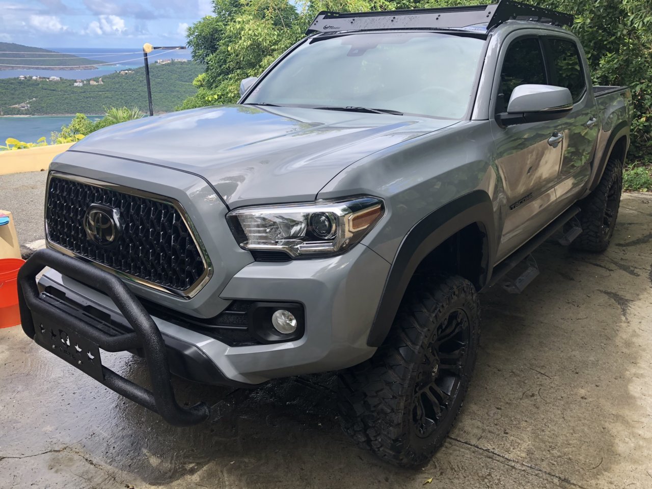

    I have attached a picture of the truck as Im pretty stoked on it as I know everyone on here is about tacoma's. Having it not start is a real ball kicker!!
