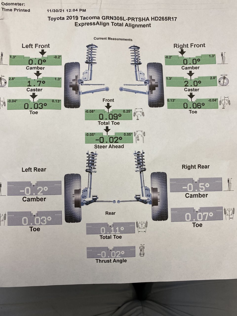

    I'm at work and forgot to bring in the print out but the caster is a little above 1 and camber and toe are both right about 0 exactly

    Need to bump that castor back up to around 3.5-4. It will make a noticeable difference

    It was actually in the truck! Here it is

    The increased castor allows the suspension to cycle smoother when you hit little bumps

    Stick geometry 3-3.5 is fine. But if you think about it as you are moving forward and hit a bump, the increased castor allows the tire to cycle up and back vs straight up. It just allows for a smoother transition from the suspension going from not moving to moving.
