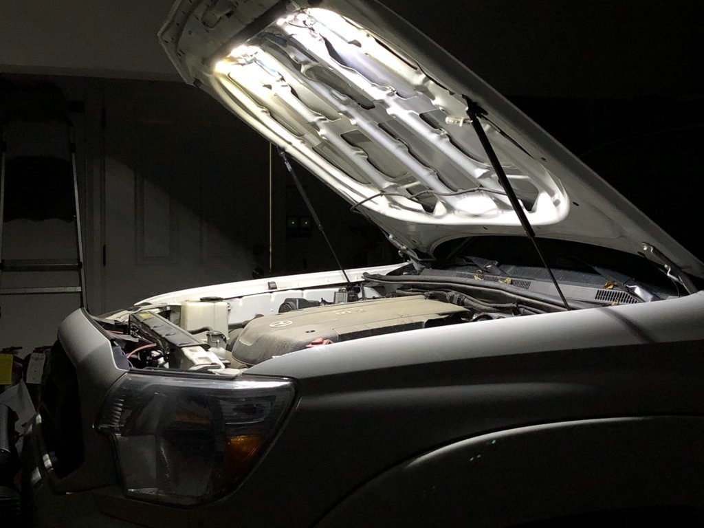

    @RedlineTuning I installed my struts last week...wishing I had done years prior!!
    No more Prop Rod!!

    What light setup do you have under there?

    Just some cheap eBay led bed lights I adapted to be underhood. They’ve been great for three years now.
