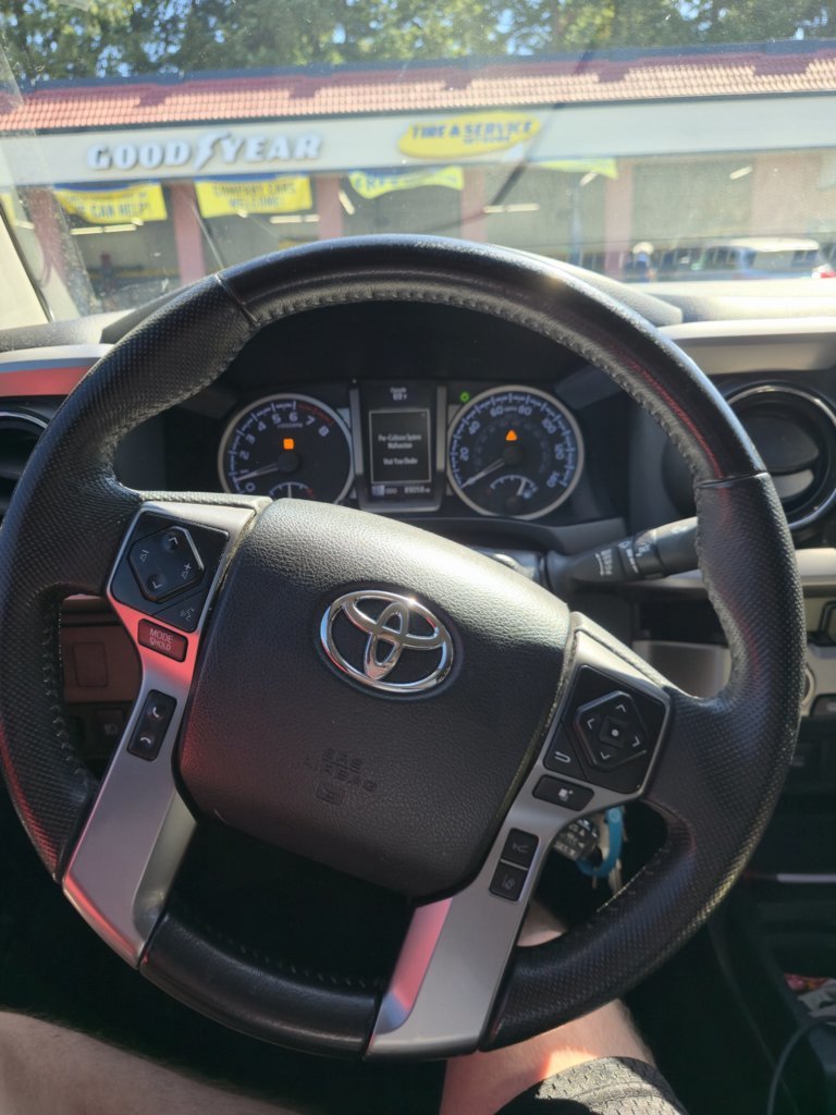

Help. Is this just an alignment issue

    Also cruise control malfunction light and will not let me engage it. Steering wheel is not straight turned to right a bit

    Yes, lower control arm cam bolts probably shifted a millimeter or two. An alignment will correct it until you bump them again off road or hit a curb/pothole. Cruise control will work again once the steering is centered .
