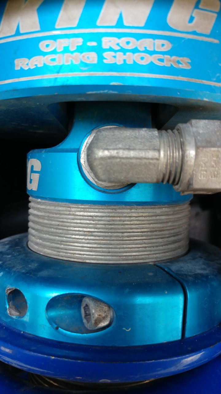

    This is what happened to me as well. The same shock that wouldn't turn without spinning the shock cylinder leaked oil from the hose fitting. I didn't even think I had touched it. King suggested that it was OK, but that I don't want to risk too much oil loss. I am with you about not wanting to risk it.

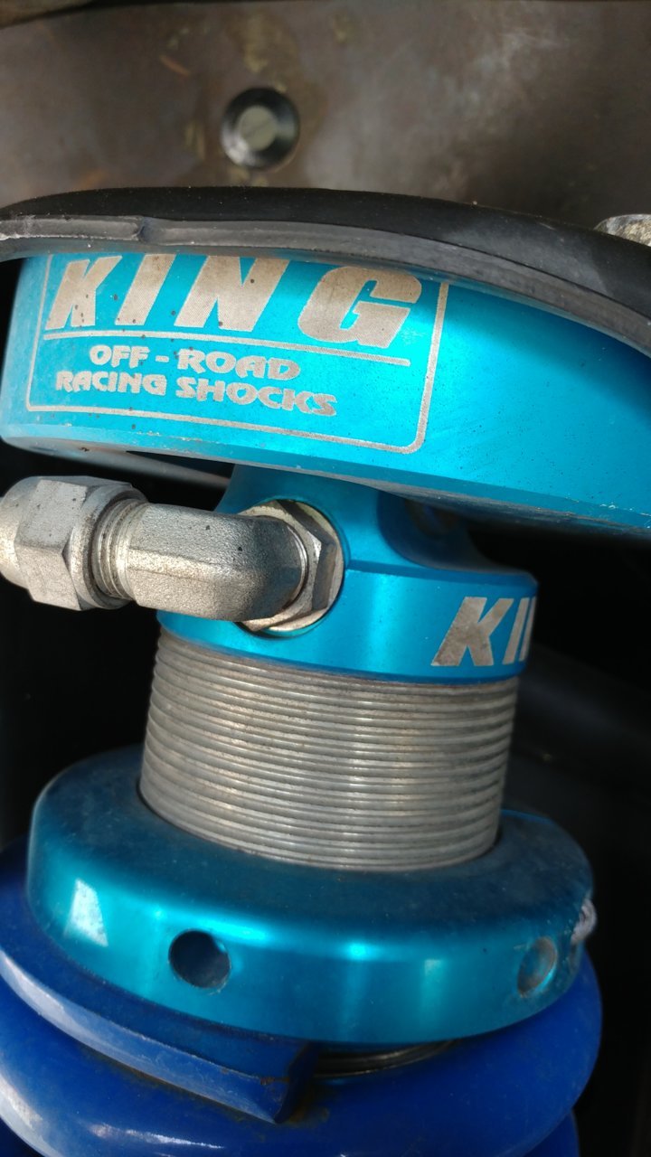

    Just installed kings ext travel with 650 springs. Do you guys know how many threads should be showing to get about 3in from stock? I was only able to get to 5 threads on passenger and 6 on driver side. It won't budge any further with it even lubed.

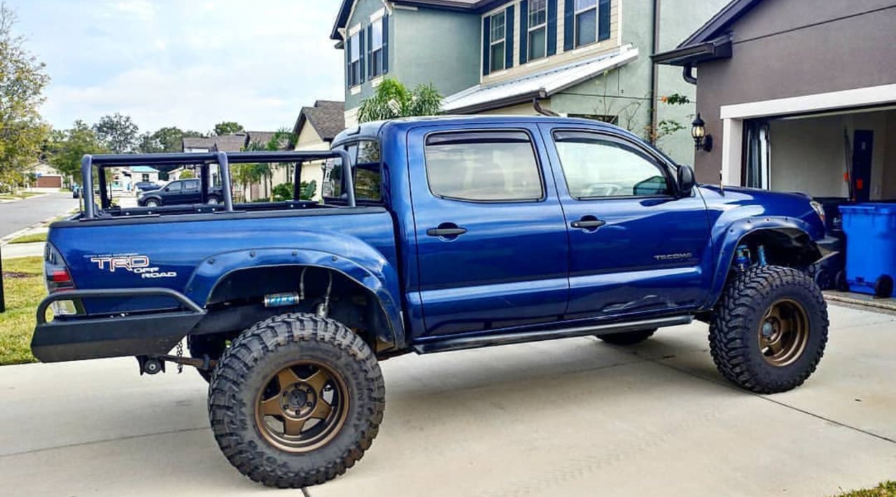

    So with a 60 lb. plate bumper up front and 650# coils I have what looks like 11 threads driver and 8 passenger
    Driver:
    Passenger:
    Truck:

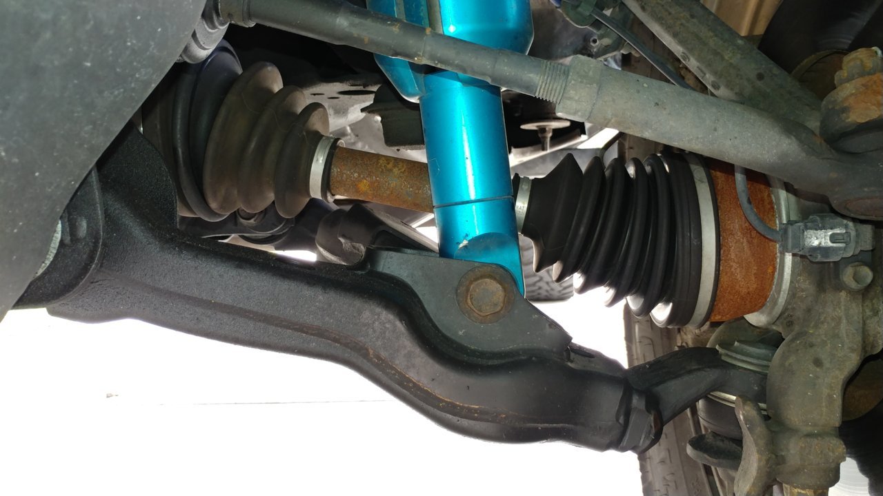

    How do your CVs look? That's a badass looking truck but the lift height makes me think the CVs must be pretty severely angled no?

    Appreciate it...Yeah I know what you mean. When I was running 600# coils I had them preloaded way down and had the harshest ride. The 650's made a world of difference. My CV angles have seen better days. I have oem CV's in the garage with all the parts for a rebuild and the boot slide mod. I just been too lazy.

    Actually those look better than mine lol. Only looks like 2 fins on the inner boot *might* be rubbing. They say if you can slide a sheet of paper between the fins then you should be okay

    Those 2 fins are definitely touching. You can see the clean area around the outer portion where they touch while rotating.

    Thanks man. Did you have to preload the coils off the vehicle? With my coils on the vehicle it's too much pressure to get it to turn.

    Yeah they were off the truck...I'm lucky enough to have full access to an auto shop that has a wall mounted spring compressor so I actually had the coils off while I adjusted. Tedious process but easy as hell to adjust. Here's a quick clip from my IG https://www.instagram.com/p/BrbFCVwlTef/?utm_source=ig_web_copy_link

    With the King tool it works even better with the King T handle too. Done it many times with more preload. Lift truck till wheels off ground, loosen the allen just enough not a lot, and put some muscle into it.

    I did use the tool and it bent it slightly lol. Don't know why it's that hard

    Granted it's a 1st gen but on my 04, I find it's really easy to adjust the preload one way or the other if I jack the front of the truck up and take the wheels off completely. Little bit of dry lubricant sprayed on the threads for good measure

    Weird, did you ever remove screw too far and turned it? Did at one point you turned it and it got tight all of a sudden?
