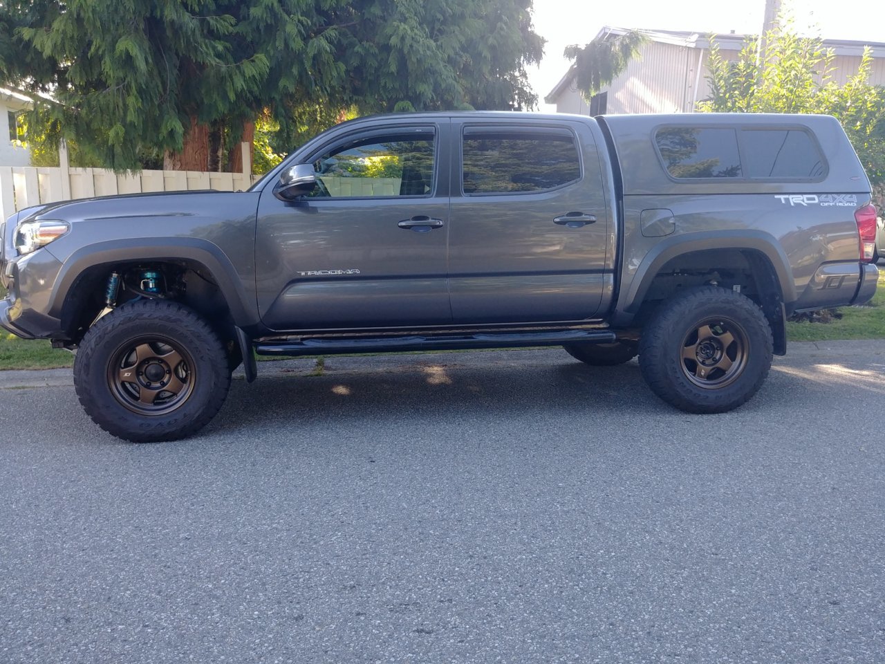

    Just installed my Kings with 600# springs, I pre adjusted the preload to 7 turns over Kings setting. My truck is pretty much stock weight, had Icons stage 1's before but the leaked and needed to be rebuilt so I splurged and invested in my current setup
    My Icons had 3.125 in of lift over oem specs also I run All Pro expo leaf packs the matched the ride level
    With the Kings installed I now have 3.625 of a lift, making the front ride much higher, I would like to reduce the turn down 2 full revolutions or should I drive for a week or more to see if it will settle down close to my Icons height.....will the settling go that much??
    I am hopeful that it will be relatively easier to adjust the coilovers on the truck when adjusting them to less threads showing:fingerscrossed:
  14. Aug 17, 2020 at 7:53 AM
    #74
    AccuTune Offroad
    AccuTune Offroad Well-Known Member Vendor
    Jan 28, 2019
    #281012
    1,655
    El Cajon, CA
    What are the shock lengths at ride height? Looks pretty tall
