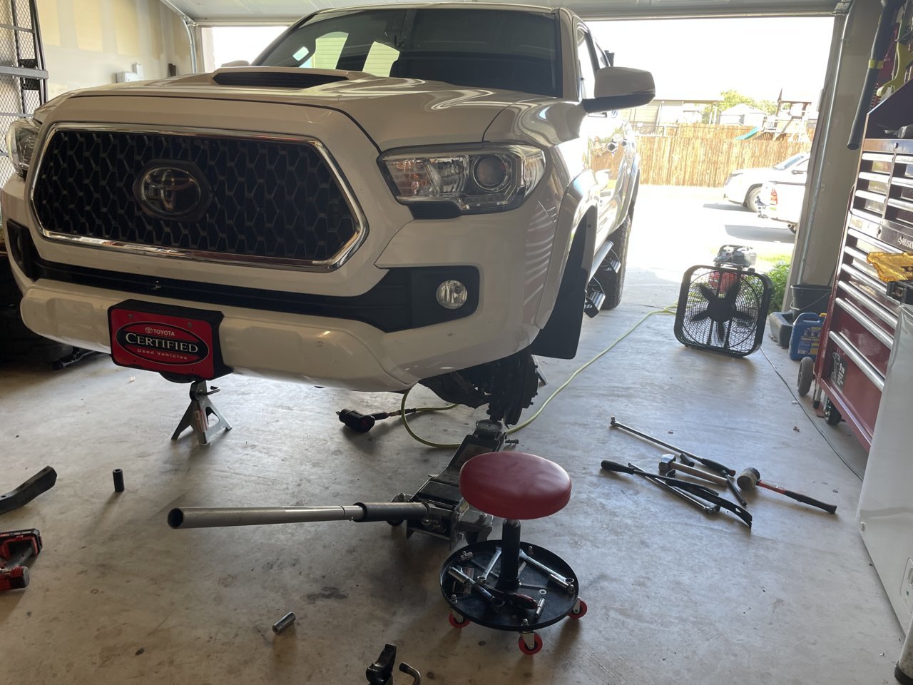

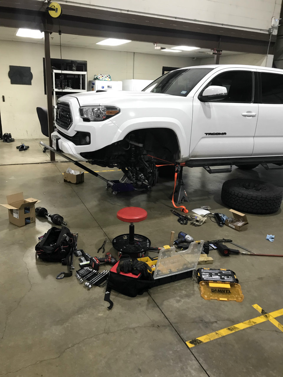

    My dilemma: I have a knocking sound coming somewhere from the suspension. I only hear the sound when going over bumps or dips. I can mimic the sound by jumping up and down on the bumper or pushing up from under neath the bumper (bench pressing the bumper). I can mimic the sound from bouncing on top on the rock slider or pushing up from underneath on the LCA. I have done every thing to chase the knock! And I mean everything for the exception of replacing the entire lift.

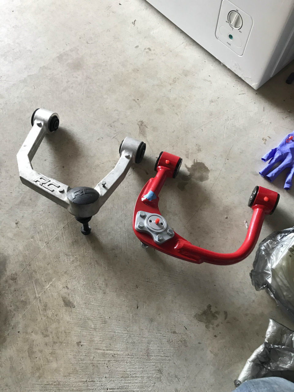

    You can feel the knocking in the UCA at the ball joint. Although this is not the issue and here is why. I called RC initially about the knocking and they sent me out new UCA's. This did not fix the issue. After consulting with a toyota engineer, I found out that the tapered angle on the UCA bolt could of been the issue. I ended up buying brand new UCA's from JBA off road hoping this would solve my problem...nope! knocking still persist. After speaking with JBA rep in great length we determined that the issue maybe coming from my steering knuckle. Our suspicion was that the soft metal in steering knuckle, where it connects o the UCA ball joint stud was hollowed out, causing the ball joint stud to not seat properly. So I bought a bran new OEM steering knuckle. Guess what...this did not fix the issue. There is a laundry list of other parts I replace trying to chase this knocking sound. Including parts that wouldn't affect the up and down motion of a suspension. I have replaced the cv axles and the needle bearing in the diff, end links, UCA's, and wheel hub assembly. I had a reputable 4x4 company here in Austin TX put the truck up in the air. I had 3 mechanics and myself all trouble shooting the sound (again I am mechanically inclined and I speak the language). They did all the proper test, they checked the lower ball joint, bolts for torque, UCA, etc...They diagnosed the truck as possibly having bad strut, but I could tell they were perplexed as well.
    What next: Im going to replace the long bolt that goes through the UCA. I have replace the UCA multiple times and the bolt looked fine to me every time but that is the last ditch effort I have before removing the lift.

    @fatfurious2 I know! Me too, but I now have JBA off road UCA's on the truck and its doing the same thing. You can see the JBA's in the pic I posted, they are red. The RC are silver color.

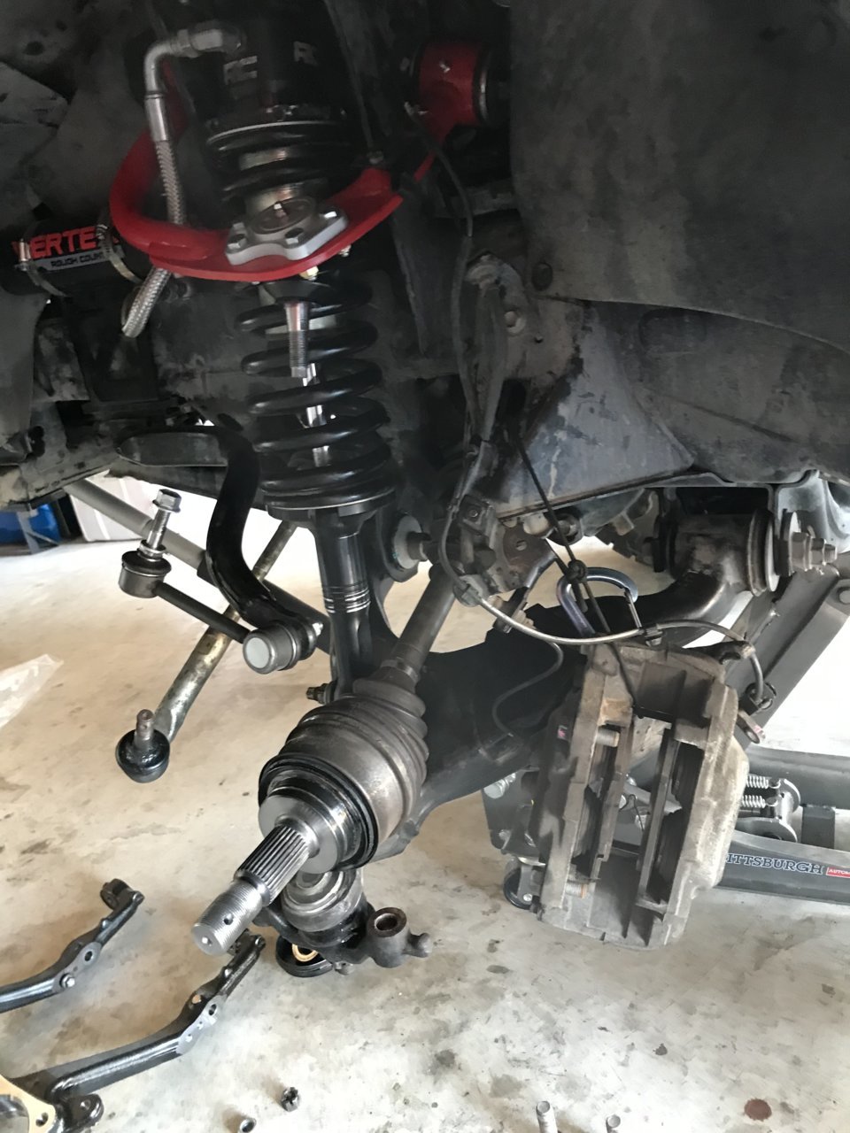

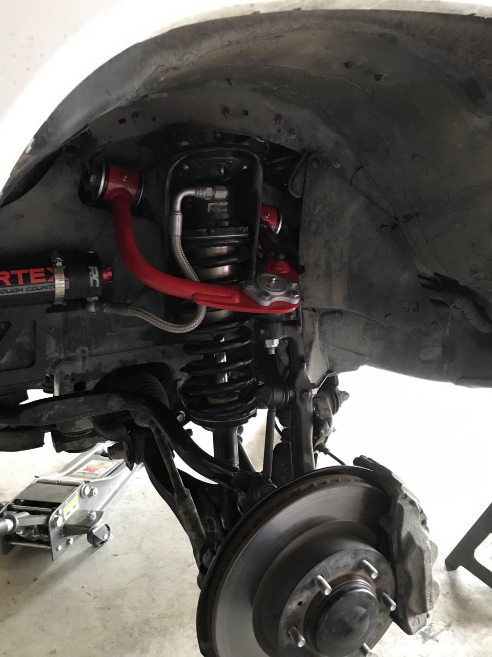

    I like the idea of switching out the bushing on the coil overs. I have taken out the coil overs several times to inspect and also to adjust them to 3 inches in height. The knock is on the up travel. I can mimic the knock with the lightest push up on the bumper from underneath. I agree with a lot of y’all on just swapping the coil over-unfortunately I don’t have an extra handy. I know that in the video it looks like a bad taper and you can even feel the knock in the ball joint but it’s definitely coming from somewhere else. I have physically lifted the ball joint boot and put my finger on the stud while having someone bounce the truck and there is no play nor can you feel the stud move-it’s seated solidly. I’m gonna get more video up today. @chuymoreno @erok81 @Technique
