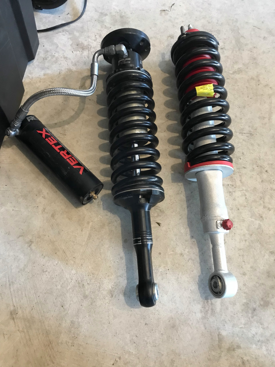

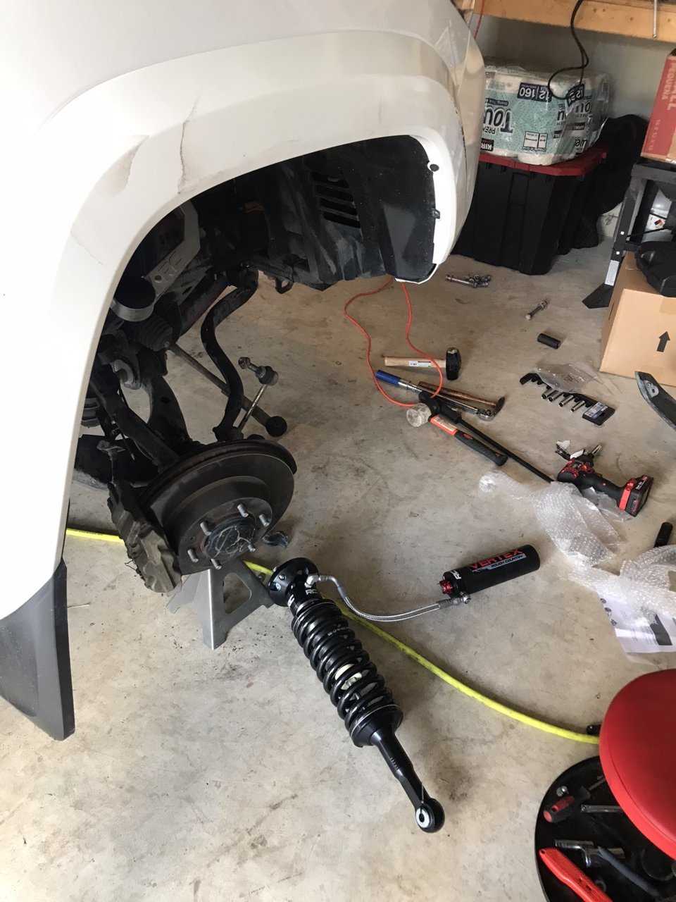

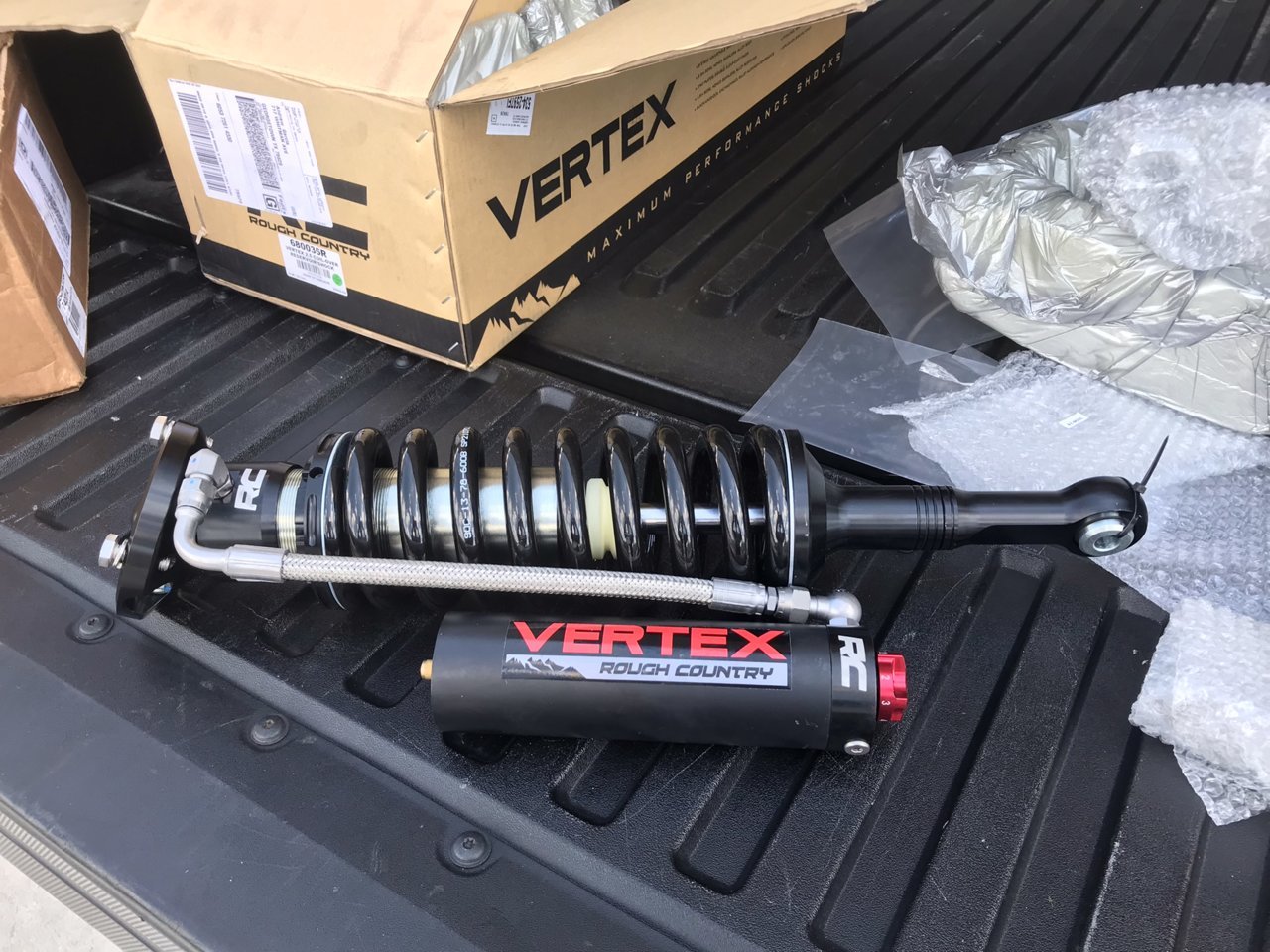

    I have not checked the body mount! Definitely worth a looksee. RC does have spherical bushings/bearing (metal) on the bottom. I have inspected those and they are fine. The top of the strut has a something similar where the mount plate connects to the strut. I can check those too. The entire kit on has about 4K miles on it.
    I have remove the coil over and I have pryed, pulled, manipulated all components, and have never been able to mimic the knock. Which leads me to believe y’all maybe right and it’s something with the strut itself.

    PROBLEM SOLVED!!! After reading every ones comments I decided to go to auto zone and purchase a rancho quick lift strut. Slapped on the part and the problem was solved! Thanks @Technique for the suggestion. It was my last ditch effort and Im very glad it worked. Now to take off the entire lift and return it!
