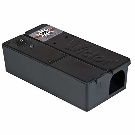

    I bought this on Amazon a few years ago and works great for mice, no guts to clean up and a pretty quick death for the little fuckers. Peanut butter and a wet dog kibble are great bait
