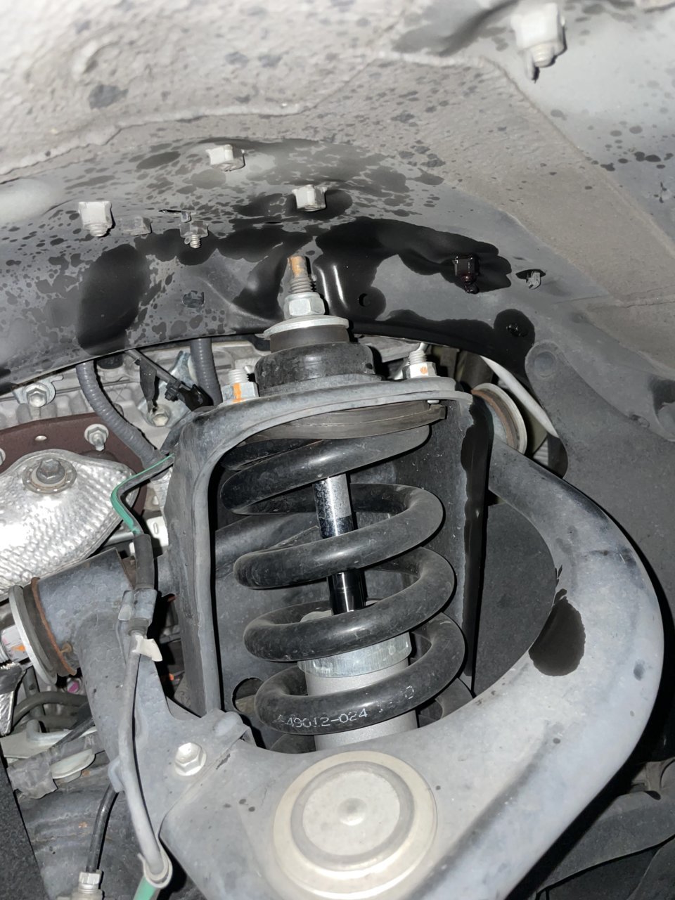

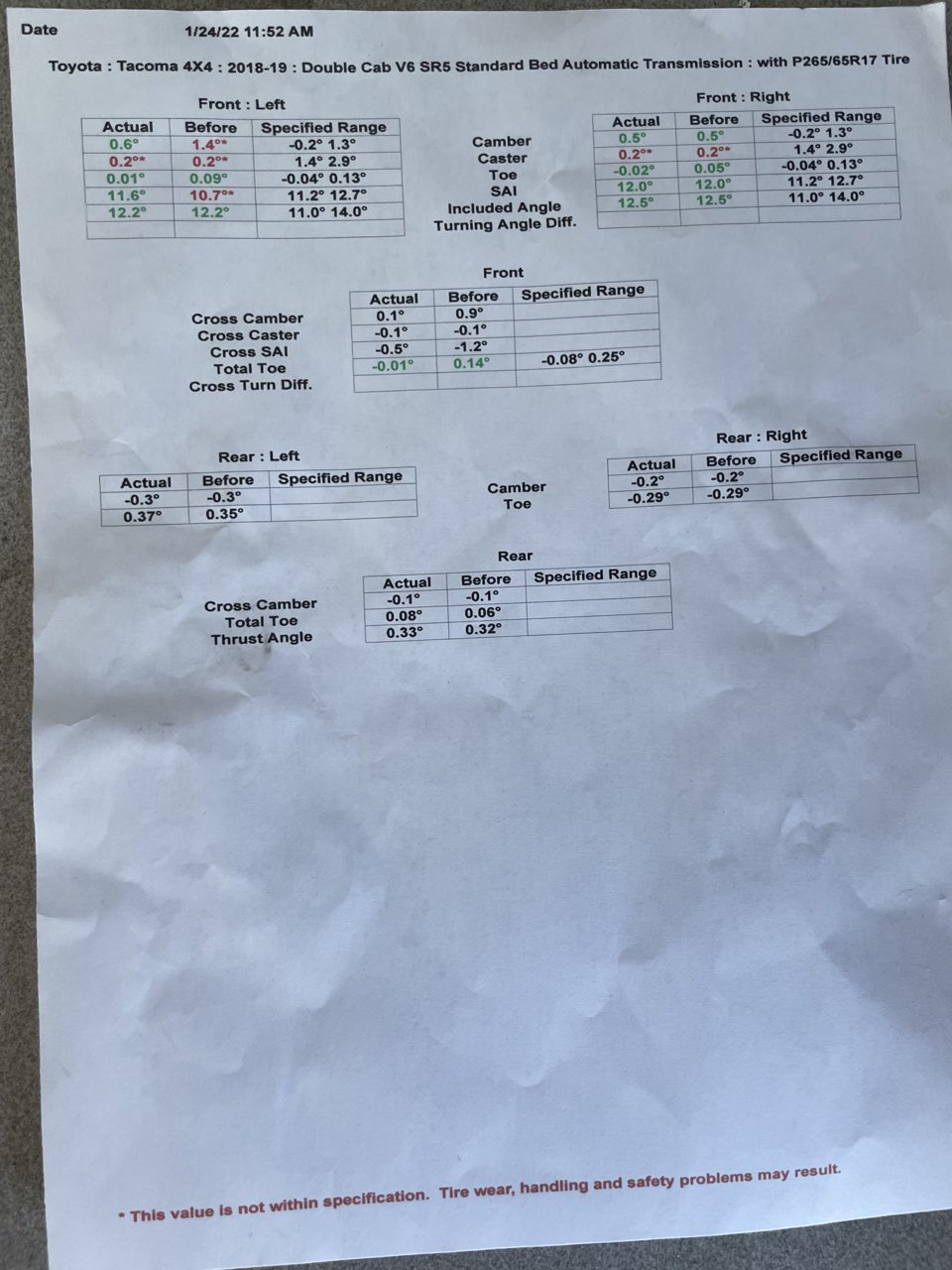

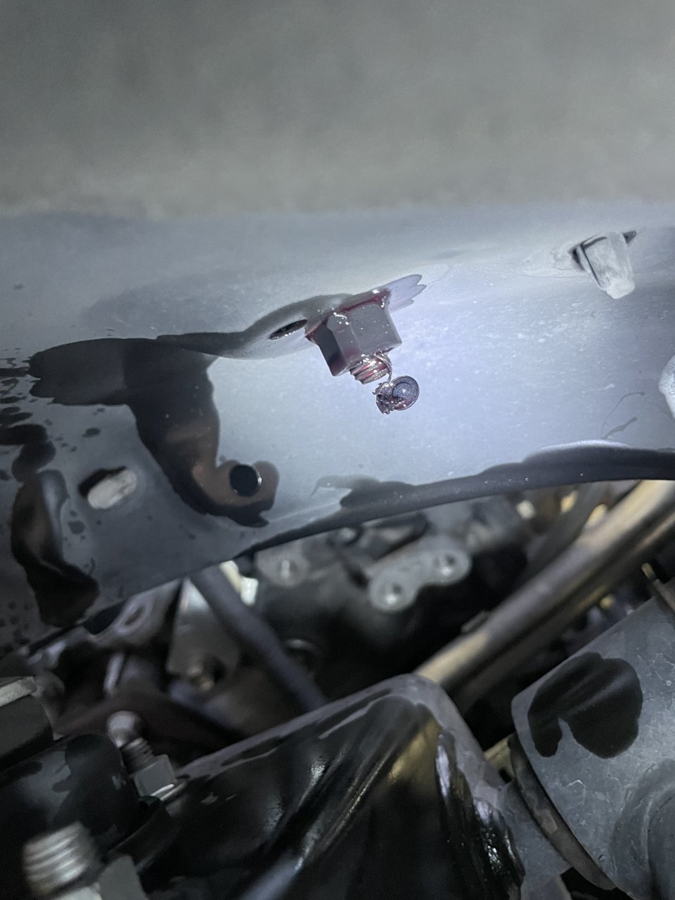

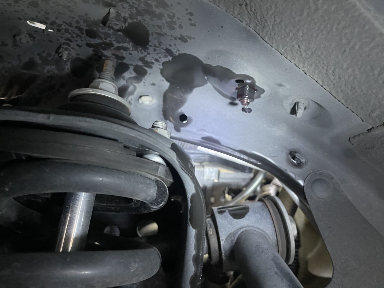

    2725EA5D-226D-4698-A011-F645CE08F30C.jpg 98BDDF63-F993-4269-AF4E-CCCA4CAEF996.jpg DA4A220D-4871-4BCC-993F-348BBACCDFBB.jpg 6AAFEF99-F9D8-4B02-8555-465DC09DCAB1.jpg Hey guys can you help me identify which fluid is leaking. It’s on the front passenger side wheel well that I just found out today. Also I’m running on 3” lift Rough Country with stock UCAs and 285/75/17 wheels and I just did alignment today. Caster is way too low. Is there anyway I can bring up the caster to the spec? What are the consequences if I run on this low caster too long?. Thank you!

    Maybe look above the wheel well? I'll second that it looks like PS fluid.... but only one way to find out.
    What exact lift are you running? You need UCA's w/ a 3" lift regardless.

    Looks like overspray of penetrating oil, they were probably spraying stuff down to make adjustments for the alignment.

    Do you have an oiled air filter? My k&n made a mess when I cleaned it and reoiled it cause I used too much. Also was red fluid

    Found the problem. K&N preoiled way too much. Never had this problem before but well it happens I guess. Thank you for the help guys!!!

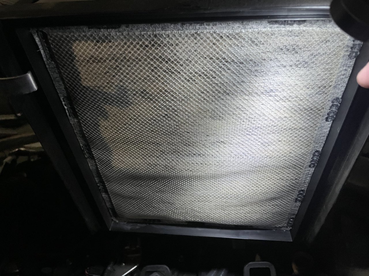

    30B666F4-8EA0-47E0-A2F3-AF6829050AD3.jpg The top part is still pretty clean. Do you think if the oil has already got sucked into the engine already?
  11. Jan 24, 2022 at 11:17 PM
    Montana_Actual
    Montana_Actual ;)
    Nov 2, 2021
    #381174
    2,124
    Take the intake off and look inside.. If that much oil leaked and you drove with it, probably. Is that carbon filter wet? You might be okay because of it, but if that carbon filter is wet, it's trash and then you go further. Can you also share what the filter and below it looked like?

    I'd just blot that top piece with a paper towel. Maybe check your throttle body and maf and clean/wipe out if needed.
