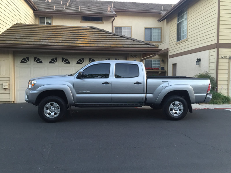

    5100's with the fronts set at 1.75 will level the truck. Had that setup on my '06 and just installed it on my '15. Left the factory coils, no AAL in the rear or anything. Here's my '15 with the 5100's installed. Looks a little nose high in the pic, but that's just the angle of the shot. It's perfectly level and the ride is sensational.

    I definitely like the looks of the 1.75, but Im just curious on how I'd look on my truck considering it reached 100k miles last month. I would rather have the rear sit higher than the front. I'm assuming the '15 model comes with the rear TSB?

    I had the same setup on my '06 SR5 DCLB. No rear TSB, non-off road. Installed at 98K miles and had 200K+ miles on it when I traded it. Same result. Completely level and great ride. The ass sagged a little when I had my race bike in the bed, but that's to be expected.
