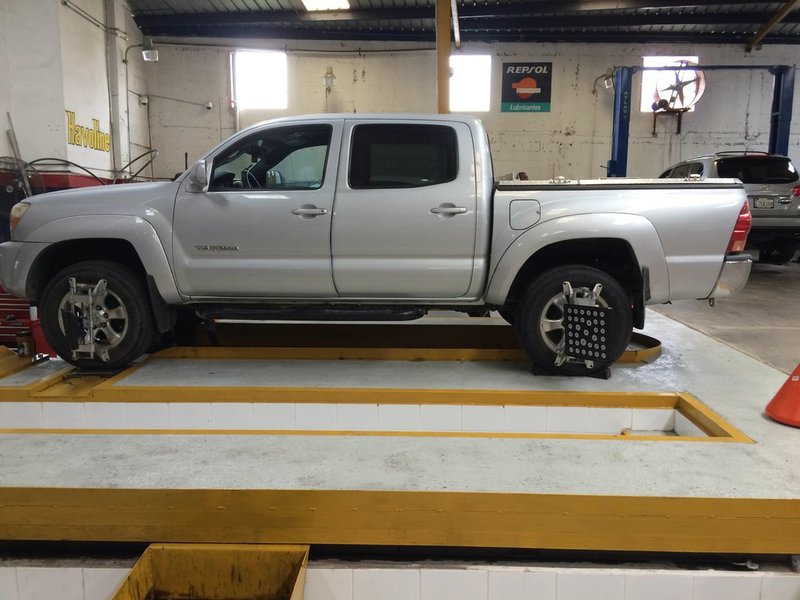

  18. Jul 9, 2015 at 1:42 AM
    #38
    libagui
    libagui Well-Known Member
    Feb 16, 2009
    #13689
    594
    Dominican Republic
    05 tacoma prerunner
    Bilsteins 5100 set at .085 Rear custom 1" add a leaf 265/70 R17 tires. Custom made aluminum tonneau cover with bike rack. 4x4 conversion with 4Runner transfer case.
    After Bilsteins installed set at 0.85 I'm getting:
    FL before 20" , after 21.25"
    FR before 20.5" after 21.75"
    A total increase of 1.25" each side.

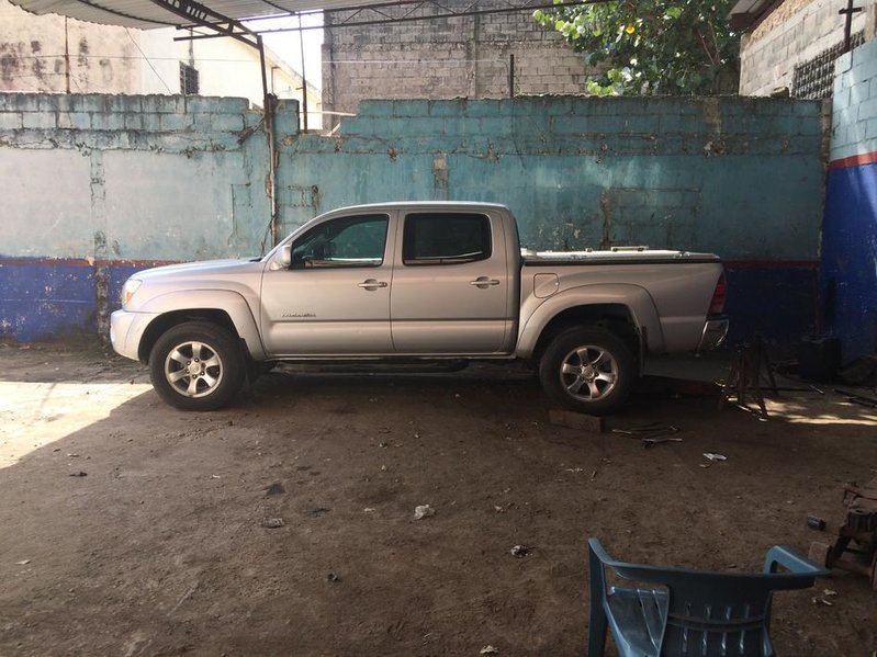

  19. Jul 9, 2015 at 1:49 AM
    #39
    libagui
    Feb 16, 2009
    #13689
    594
    Dominican Republic
    05 tacoma prerunner
    Prior I had lifted rear 1". Always is better take measures front wheel center, so you can compare with others using different tire size.
    Before lift, rear height were 20 3/4 left, 21 1/2 right and after lift 22 1/4 left and 22 1/2 right almost perfect.
    Next week, Bilsteins will be arriving, then I will install them with stock springs at 0.85". I think a lot about changing springs with OMES, but I'will give old springs a try to see how will be the new suspension arrangement feeling.
