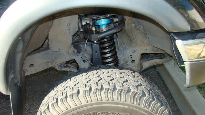

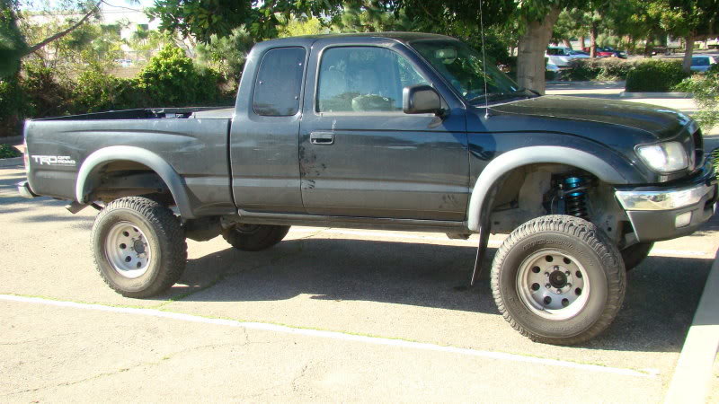

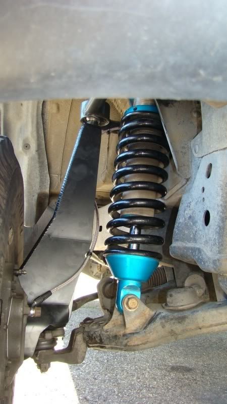

  13. Apr 17, 2011 at 9:40 PM
    jblaze805
    jblaze805 Well-Known Member
    Nov 20, 2009
    #26253
    1,127
    Ventura/Fresno, CA
    04 trd pre-runner
    2.5" king coilovers, caburg uca, magnaflow exhaust, aem intake
    heres my set-up hope this helps and u like how much lift im getting.
    king's @ 1.75 w/ solo 3" front, 3" all pro expo's w/ 5150's which gave me about 4.5-5" of lift in there rear.......

    Looks good jblaze805...so how many things did u have to buy seperate then? Or was it a kit? And that's a total of about 3-3.5 inch lift then?
  15. Apr 17, 2011 at 10:14 PM
    jblaze805
    Nov 20, 2009
    #26253
    1,127
    Ventura/Fresno, CA
    04 trd pre-runner
    thanks tsk...and yes it was more of a work in progress type thing buying things little here and there, bc the all-pro expos and lift spindles didnt come out till this year...but the first things i got when i bought my truck in 04 was the king coilovers and upper control arms.....my truck right now i would say is 4" ish lift....
